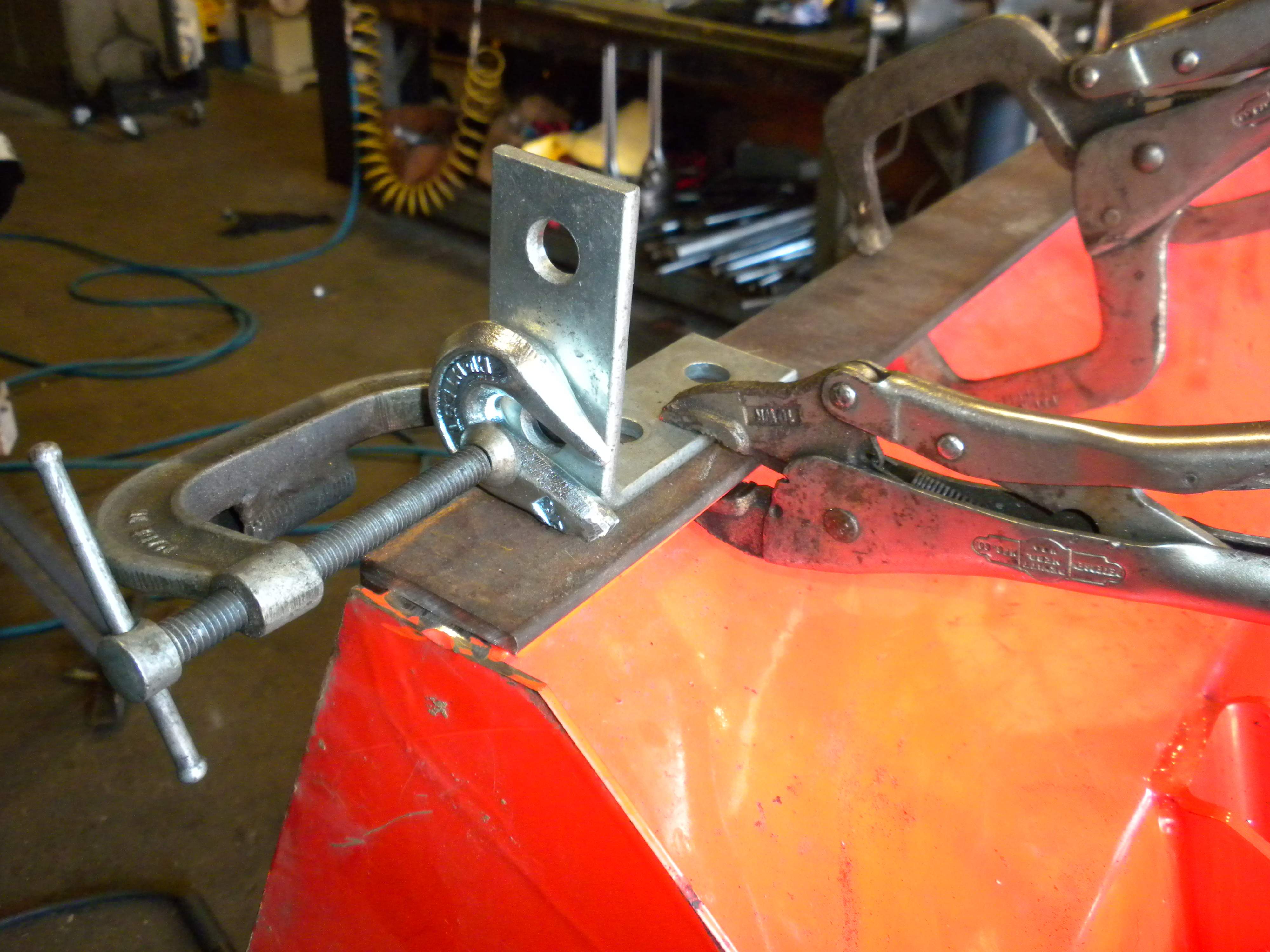

Might as well add the bucket improvement also......it'll come in handy......better to fix it before I bend it..:thumbsup:
