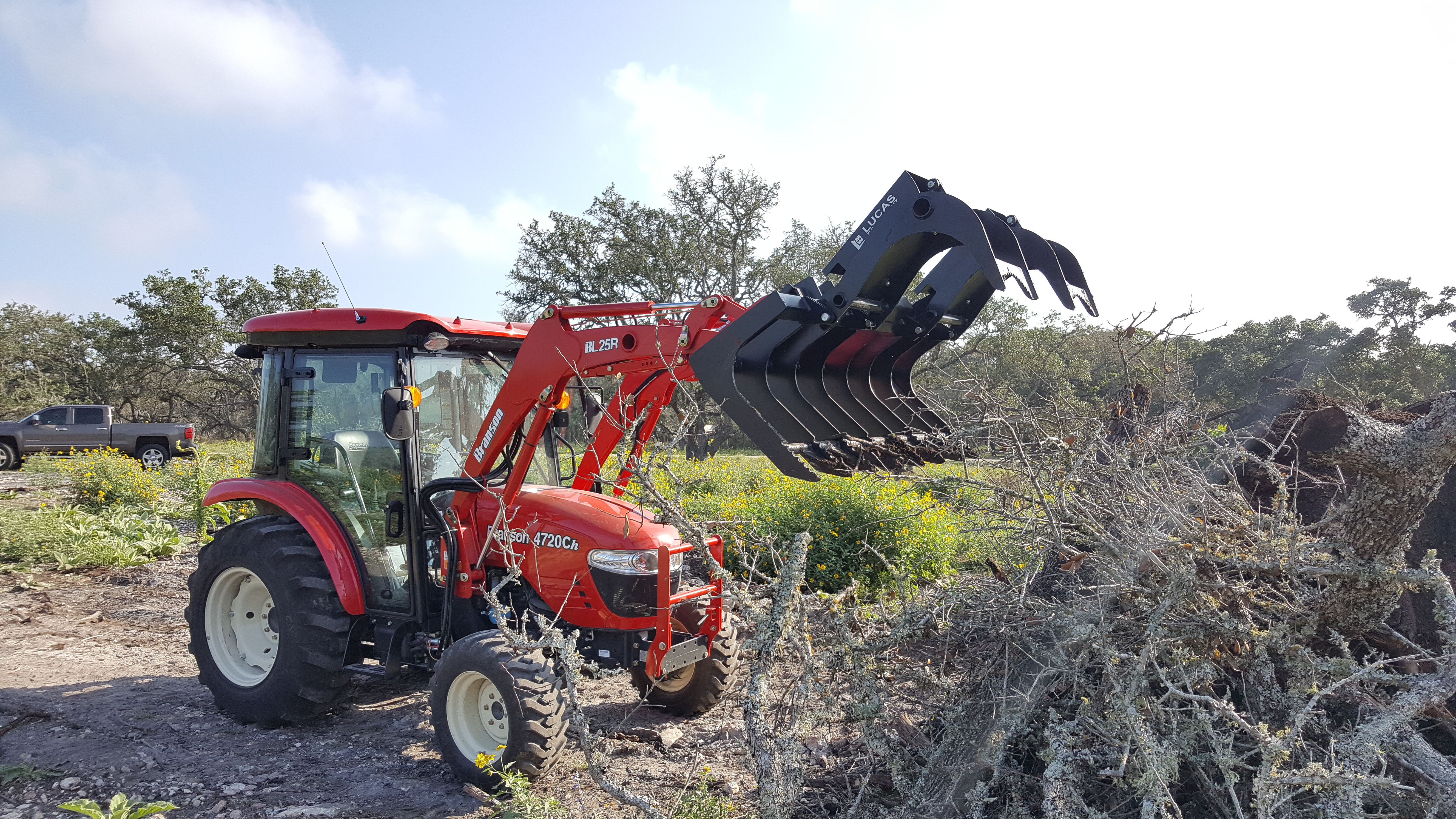

Here are some photos Hopefully they help you...
I have to make a small adjustment to one of the levers to get it centered up but other than that it went together quite easily. One tip... Assemble as much of the lever assembly as possible then get it loosely in place before installing the valves. I did this and it sure saved me some trouble installing the controls as there are some small cotter pins involved and it would have been awkward for sure!
These are very helpful. If a fellow wanted to put on a grapple, could you use one set of these remotes for opening/closing the jaws? I am thinking of getting a grapple but would prefer to have a set of rear remotes and just use one function for the jaws instead of having to run a button on my loader control, I think.

Absolutely. I have ordered a grapple and expect it to arrive in 2 weeks or so. As we're so close to each other pm me if you want to find a time when you can come look at it. I installed my 3rd function valve tonight, but want to make some changes to it. Paint the bracket etc.
These remotes will work fine for any cylinder application but they do not have a float position so aren't suitable for a log splitter, etc.
I will be adding a hydraulic top link in the future and also will have a flail, and a rake with hydraulic offset/angle.

I have a 4720CH that came with the rear remotes...
I am using a grapple that is connected the to remote that is labeled "II", that remote lever returns to center.. I plan to use a log splitter that I will attach to the remote labeled "I", that remote lever locks in either forward or backward positions.. the rear position has a symbol that looks like this "~" , I'm thinking that might be the position I want to use for the splitter... 20160828_092405.jpg
