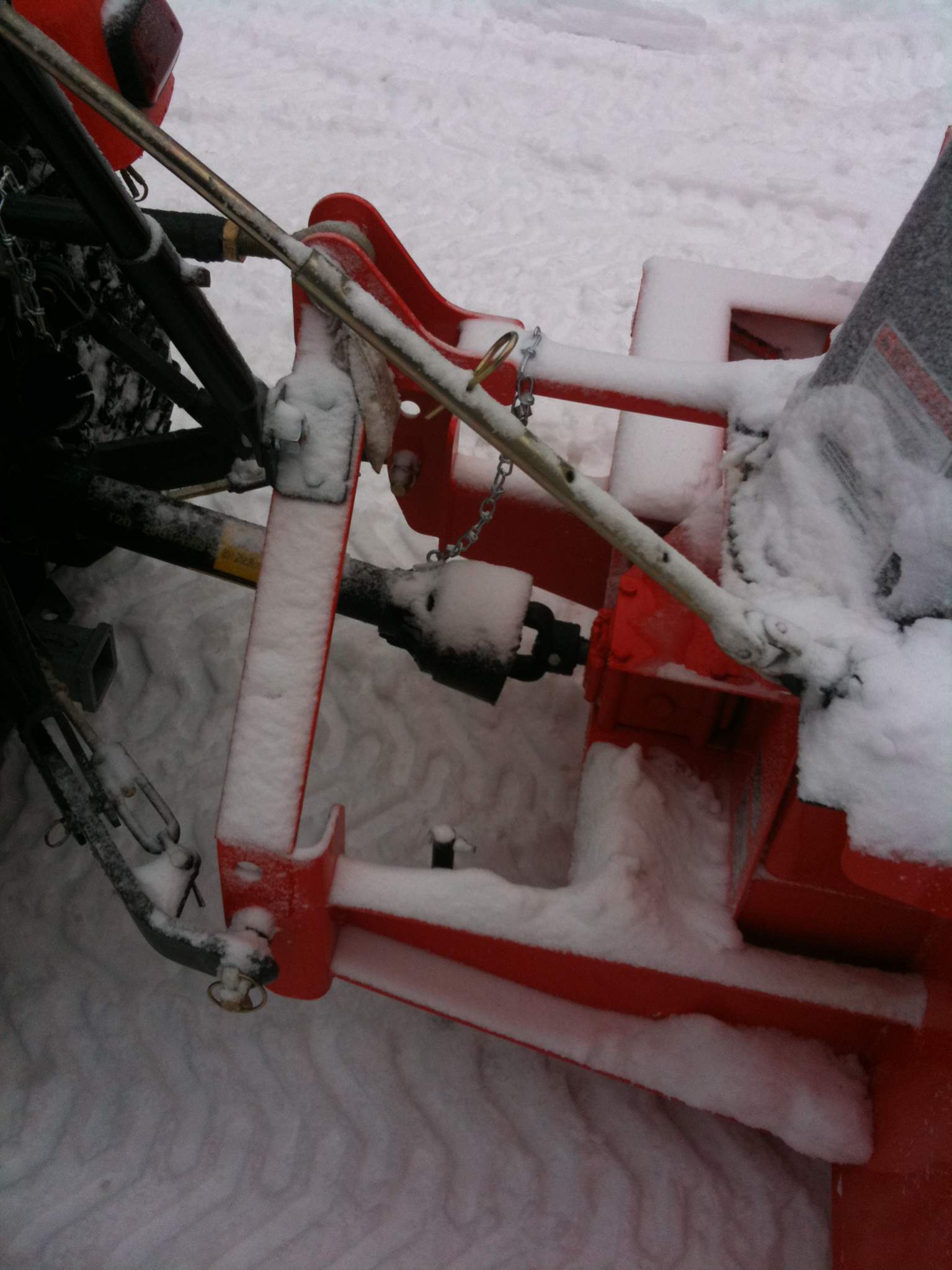

I have a rear-mount blower on my BX25, and when the lift arms on the 3-point hitch are fully lowered, the blower is still not quite low enough, even with the skid shoes set up as short as possible. As well, when I go up a slight incline, the blower raises up off the ground and misses a lot of snow. I looked at the blower manual (Model B2789) and could not see where the lower limit can be adjusted.
Can anyone advise me here? (BTW it would be nice if I could put the blower in "float" mode like you can do with the front loader.)

If your 3 point hitch arms are dropping all the way down, you also may need to change where the 3 point hitch pins mount to the blower. If you mount the pins higher, the snow blower will go lower. If the blower is set up correctly on the 3 point hitch it will float like you want.
   / Adjusting the height of a 3-point hitch snowblower #4
LD1 is correct, there are another set of holes in side links, my BX23 had them. Swap to the other holes and make sure you adjust your center link. There should be at least two sets of mounting holes for that, as my Grand L has 3 or 4. You can use either set depending on how high or low you want the attachment( snow blower) to be.

THANKS FOR ALL THE GREAT SUGGESTIONS, GUYS. We have plenty of snow up at the cottage (2.5 hrs. N.E. of Toronto), so I can try these ideas perhaps this weekend. There is in fact a higher attachment hole on the blower that I can switch to. (See attached photo.)
WRT holding the control lever down to get a "float" mode, will try that as well.
James

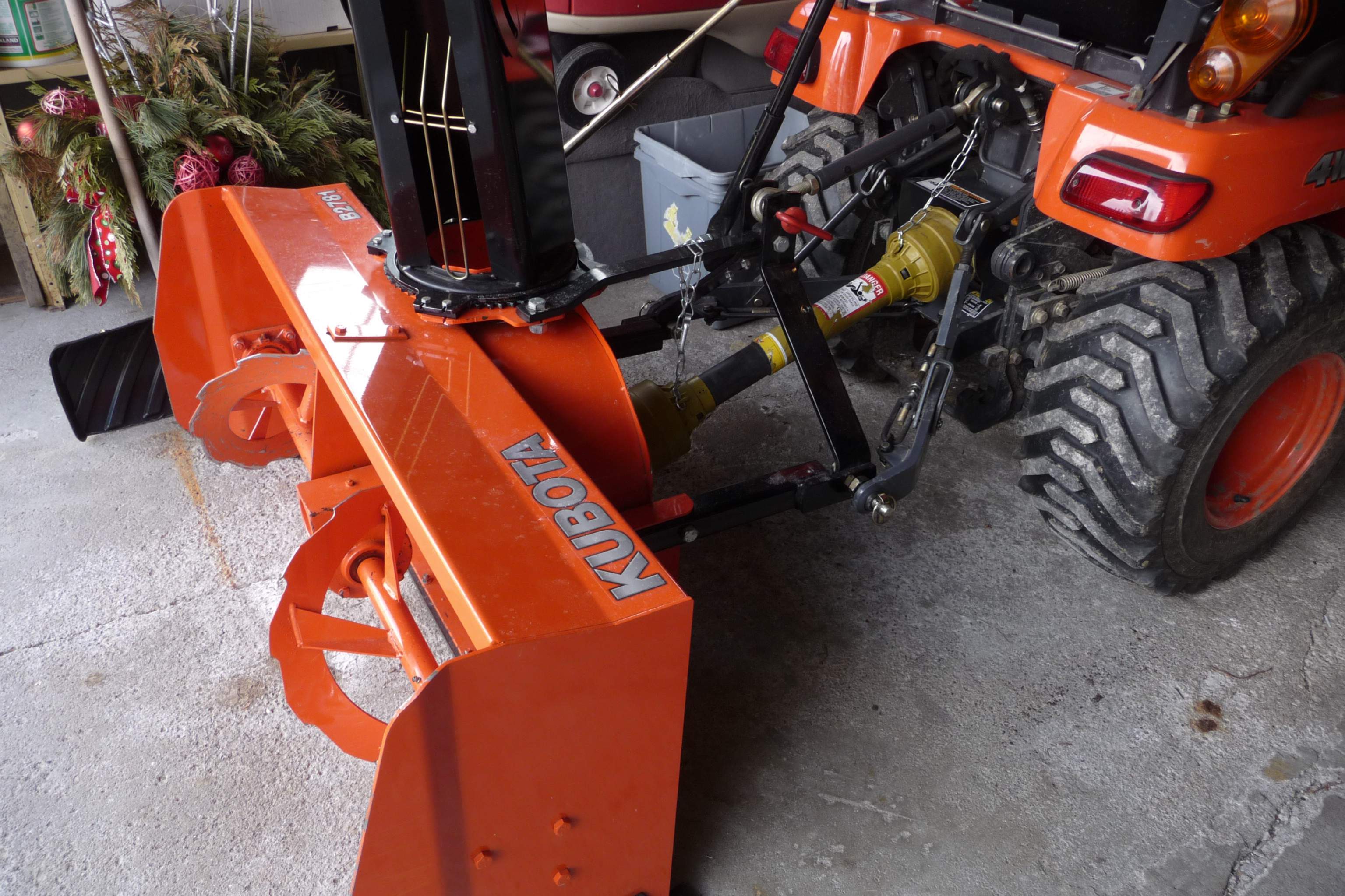

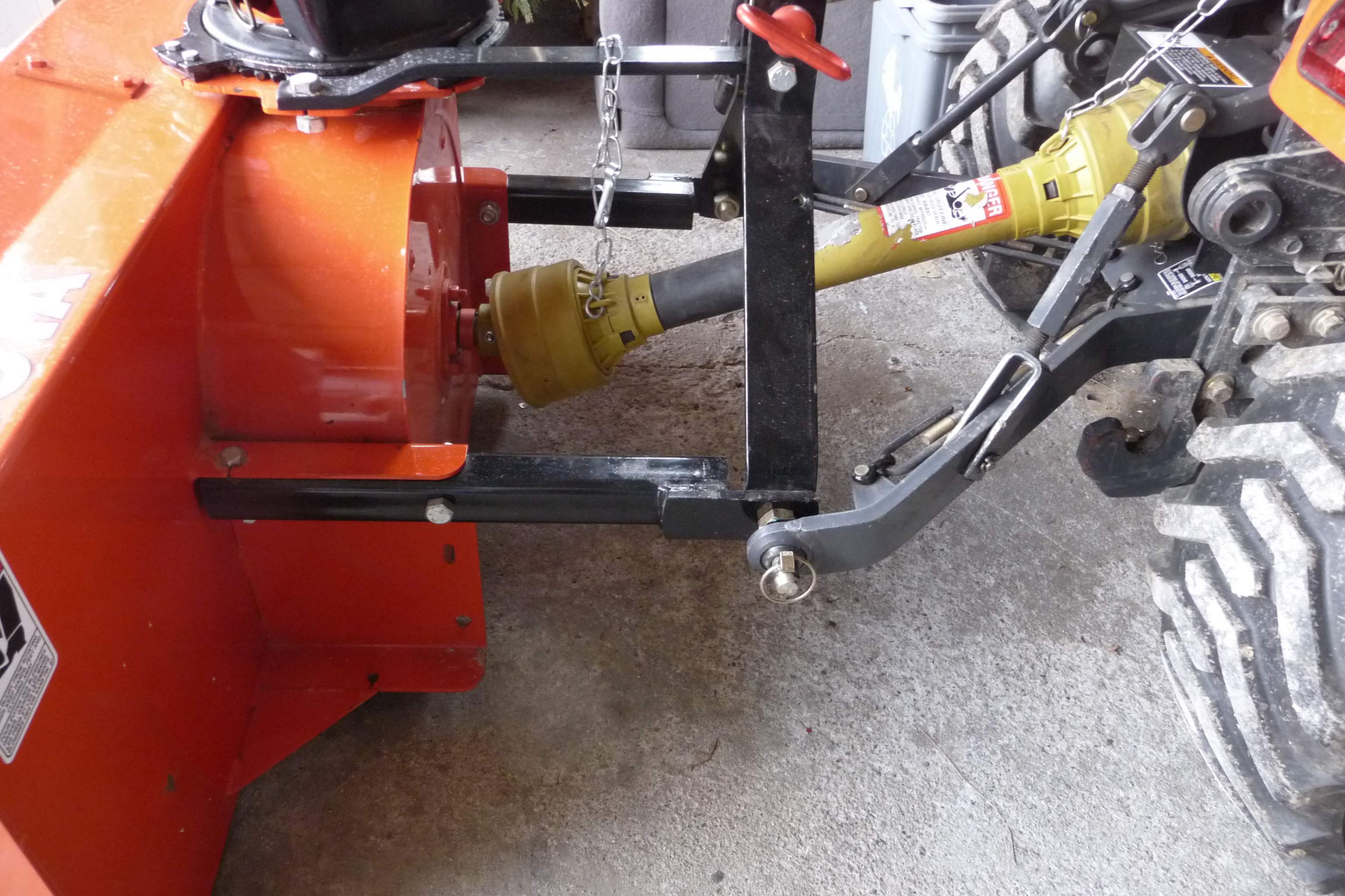

My blower is a B2781...
Here it is in the garage where it's been waiting all winter...
I just bought this setup in Sept, did some trenching/ditching out back 'til it got too wet in the fall. Thought I might get some snow blowing use this winter (I have about 300' of driveway), but nope. Took the blower off for a few hours yesterday to use the BX24 to clear up some trees knocked down by the wicked winds Saturday.
you can see how it's built a bit different than your B2789, it is gear drive, but it's a pretty rugged unit.
Pete
