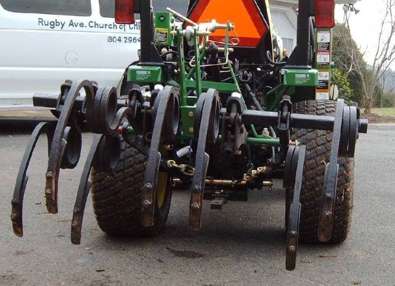

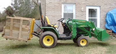

Light tractors need 4-WD for traction. Probably 90% are sold with a Front End Loader (FEL) and Hydrostatic transmission (HST). Around $18,000 equipped, plus sales tax.
I suggest a 60" PTO powered roto-tiller or an Unverferth Perfecta in lieu of plow and Disc Harrow combination.
VIDEO: Cultivating with a Perfecta - YouTube
VENDER: Buckeye Tractor Online Catalog Page 11-03 Toolbar Cultivators

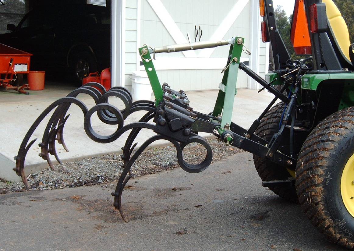

This weight tractor can operate a 60" wide Rotary Cutter / Bush Hog in grass 24" tall, a tad higher mowing very slowly. Cultivators are fine for row crops. I prefer the style of Cultivator with each tine adjustable for height, rather than all tines being fixed at one height.

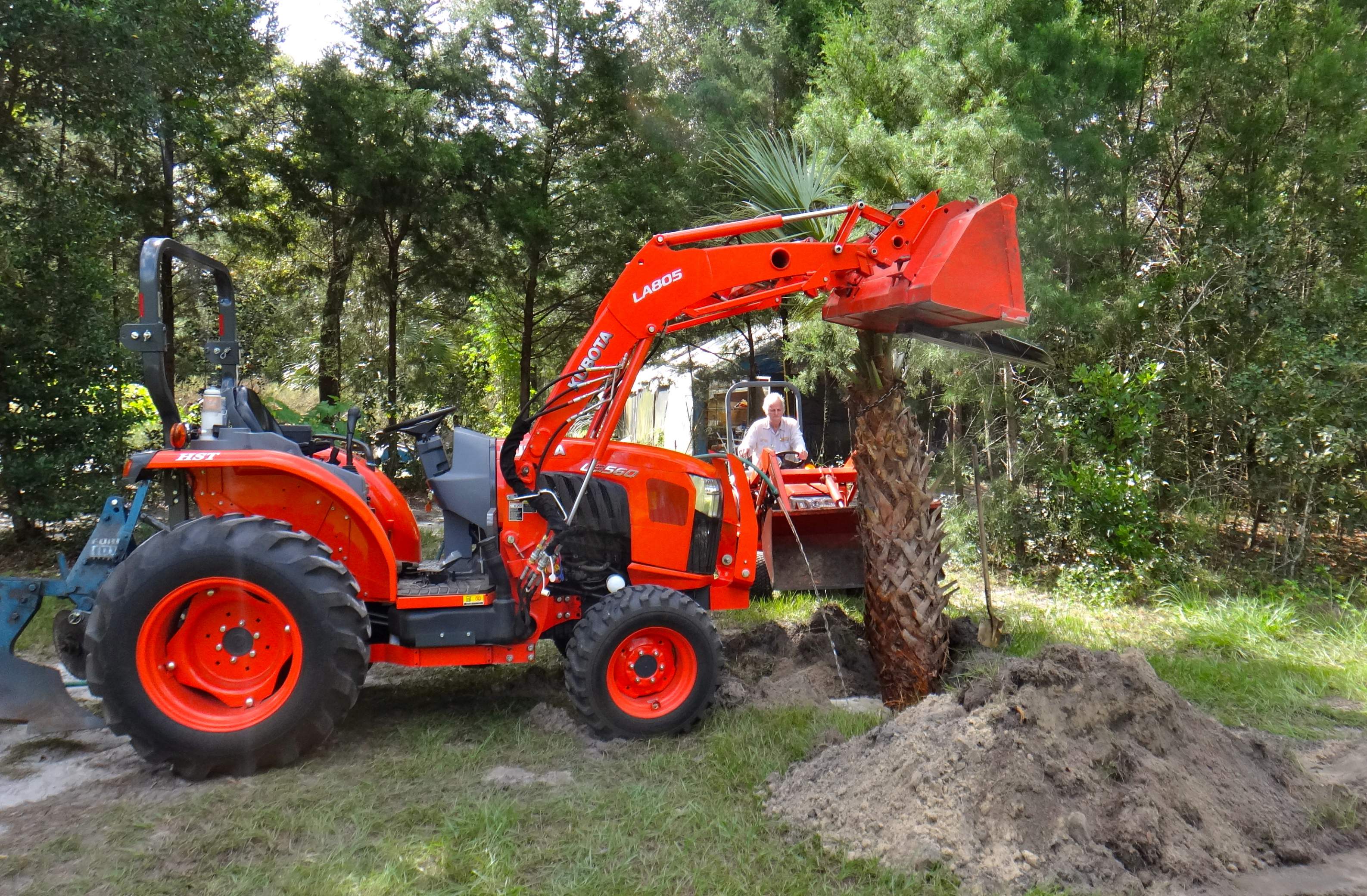

Used with prudence on a light tractor bucket, in reasonably soft soil, a Bucket Spade can be very useful for berry work and tree planting.

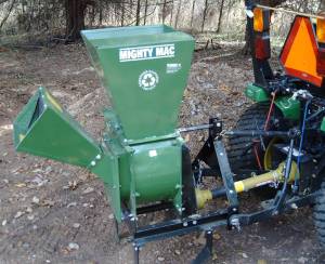

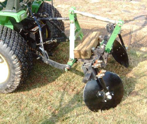

I 2nd the vote for a small tractor with FEL and bush hog. I'd also vote for chipper/shredder to handle cuttings from those fruit trees. You might be able to use a "tool bar" type of 3ph on the back like an Agri Supply Keulavator. To it, you can affix cultivators, plows, discs, etc. Look at the old JD M tool bar that I had on my 18.5 hp JD 4010 (now called a 2019E if they sold them). My most used attachments are the bush hog and chipper/shredder and occasionally use the carryall (picture of it for hauling mulch).

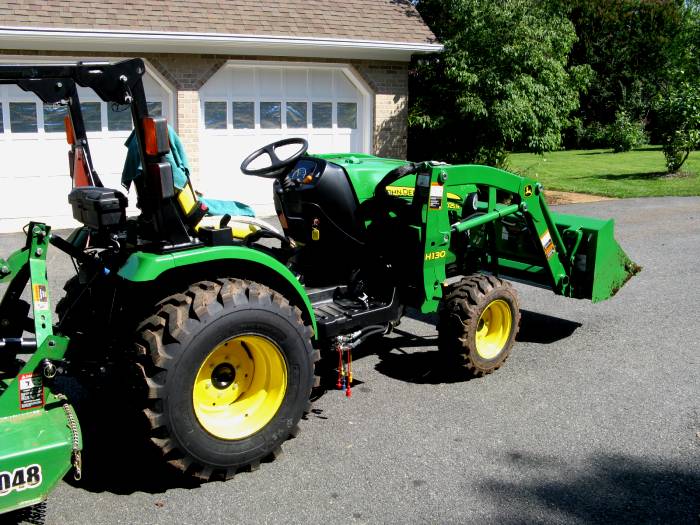

I liked the Kubota B2301 but wouldn't disagree with the B2650 or similar. Love my present JD 2025R and wish I could have gotten like a 2019R ("R" just means more nice stuff like a long reach 3PH controller and such vs. an "E" model). Love the Isuzu diesel generator, about 20 hp (12.5 kw). Think there's one tractor manufacturer that has Isuzu engines. No knowledge about the tractor.
If you have any bushes/brush or uneven ground, you do not want a SCUT with under belly hydraulic fans, and I don't recommend the JD 1025R. Had one between the 4010 and 2025R, and it was a piece of junk.
