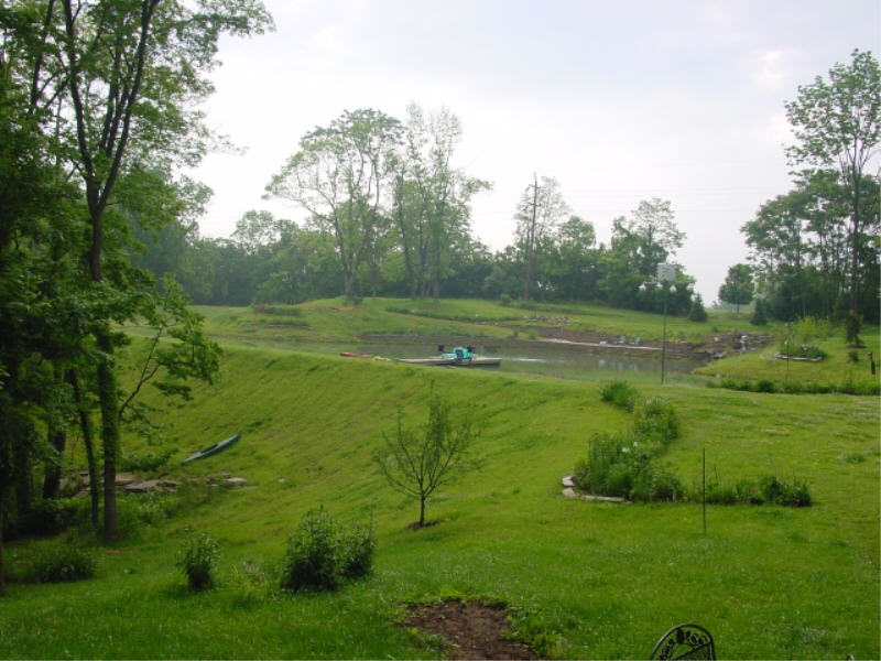

I mow a dam with R4s. I've attached a picture which is pretty blurry due to dumbing down for posting, but you can get a little perspective from the little green stripe at the bottom of the hill which is a kayak that blew over. I go up and down, of course, and with the tail of the tractor always facing up. Sections of the hill are on a 25-deg. slope or maybe a little more here and there (a couple of place feel like I'm backing the tractor up a wall). The guy who built the dam had a 30-HP Kubota and actually drove it over and over the lip of the dam to go downhill with a boxblade and rake /forums/images/graemlins/shocked.gif but he's a pro--makes a skidsteer look like a slot car!! I never get any sidewayser than carefully angling for the next swath, and so far while I've had a little traction loss I've never slid out on the dam, having done that a couple times elsewhere and figured out that I really don't like it. I use low range, of course, 4wd, and the diff lock if necessary, but mainly I make sure I've got good light, I'm not tired or in a hurry, and the grass is completely dry, although our clay doesn't really dry out unless there's been no rain for weeks. The R4s do a credible job and do minimal damage, which of course is an issue with the R1s. Of course, the R4s are designed for loader work, and having had both kinds of tires the R4s seem to me to be a good compromise for slope mowing also as long as you're focused on their limitations.
