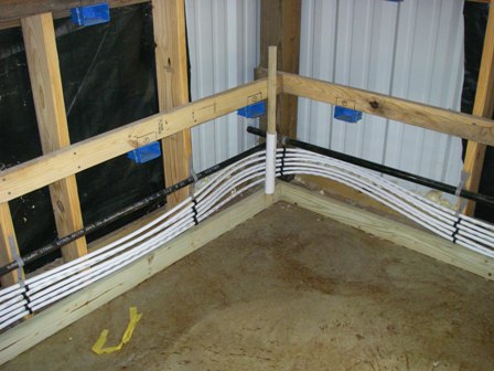

Next was the water supply, and for this I chose PEX...
The PEX piping system is absolutely perfect for my project, as the natural cavities in the walls between the horizontal framing members created built-in chases for the piping and electrics... I only had to drill a very few holes to run all the piping...
I designed the system using the "Home Run" style, where each source of water in the house has its own supply line running unbroken back to a manifold... thus, the most distant tap in the house has no more fittings than the one closest to the manifold... just two... one connection at the manifold and the other at the tap...
In between is unbroken, flexible poly tubing... I built an "unwinder" gizmo to allow me to pull the tubing right off the roll and snake it through the walls without kinking it... the slippery 1/2" poly tubes wrapped spaghetti-like around the corners without a hitch and the nail-on clips made it so easy to finish off, I was able to run all the tubing in the house in a little over 2 days by myself...
All of the plumbers down at the supply house unanimously recommended using the stainless clamp-style fittings over the crimp-ring style and now, after putting in the pipe, I tend to agree... the clamp tool will not release until proper tension is achieved versus the crimp ring tool which requires you to use a "Go-No Go" gauge on each fitting after crimping...
I found only one leak when I pressure tested the system, and this was due to a deep scratch on one leg of a "Tee" rather than a defective clamp... and if you do need to disconnect a fitting, removal of the stainless clamps can be done with a screwdriver, while the crimp rings need a special tool
All-in-all, I am very pleased with PEX... if there is any drawback, I would love to see a UV resistant product that could withstand direct sunlight.
I also included a run of tubing for residential sprinklers... the price of the sprinkler heads is so low, about $8 each, that it would be foolish not to include this important safety feature in any new construction. I estimate the total materials cost for adding 6 sprinklers to the house is around $150... I should recoup that on the first insurance bill...

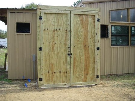

Pouring the slab for the shed was not without its drama... such a small slab is not worth hiring a concrete truck so Charles and I dragged my small cement mixer out of its storage place in the weeds back on "Tractor Bling Row" along the back fence...
Its a good little mixer... one of Precious Brides Craigslist finds, so you know we got it cheap... unfortunately the drum is mounted on a swiveling pedestal that is better suited for a plasterer rather than the small concrete jobs I need to do... the machines center of gravity is perilously high, a fact that made itself apparent every time we mixed and tipped another bag of pre-mix.... catastrophe was just around the corner thru the entire job... I finally wound up taking a tie-down strap and tying the drum carriage to the pedestal and just tipping the whole shebang over to dump it.... 18 bags later I had just about had enough of that... I will not use this machine again until I do a "chop and drop" job on the frame and get the **** thing a little closer to the ground...
I got the walls and doors built and installed the next day and it is awaiting my return to Texas next month to get its skin... the same color metal as the rest of the house, all from the scrap pile... the cover sheets the metal company used to protect my kit are more than enough to skin the walls and roof... I just need to order some trim and hang it all up... and I'll still have enough bits and pieces of tin left to make a nice matching dog-house...

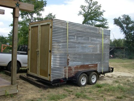

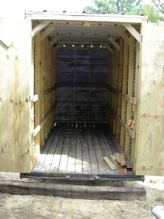

His crowning achievement this last trip was building a cargo pod on my 16' trailer...
I am going to need to start moving a lot of stuff around between the coast and the Ranch.... when I saw the price of covered cargo trailers, and the cost of rentals of trailers or trucks, I decided to build a nice sturdy cover on my existing trailer...
Like most of my projects, it is a mix of new and recycled materials... the frame is all new treated lumber with a skin of galvanized corrugated sheets salvaged off of an old bus barn... when I start towing it around, I am going to put a sign on the back of it declaring it a "Redneck Airstream" and see how long it takes for a photo of it to get to the Interweb....
I like the whole "Pod" moving concept... I will be able to park this contraption at my house on the coast and load it at my leisure, then tow it to the Ranch and unload it at the same pace rent-free...
Once the moving is done, I will have a tool trailer to keep my gear in while I rehab the coastal house for sale, and when that project is done, I foresee an honorable retirement for the pod as a chicken house, or "Poulet Chalet" as Precious Bride likes to call it...
The trailer is a full 8' tall, 15' long and 7.5' wide.... cavernous... a lot more room than the prettier stuff down at the trailer lot... even in consideration of the cost of the new materials and Charles time, this rig is a **** bargain
I'll let you know how that all works out...
