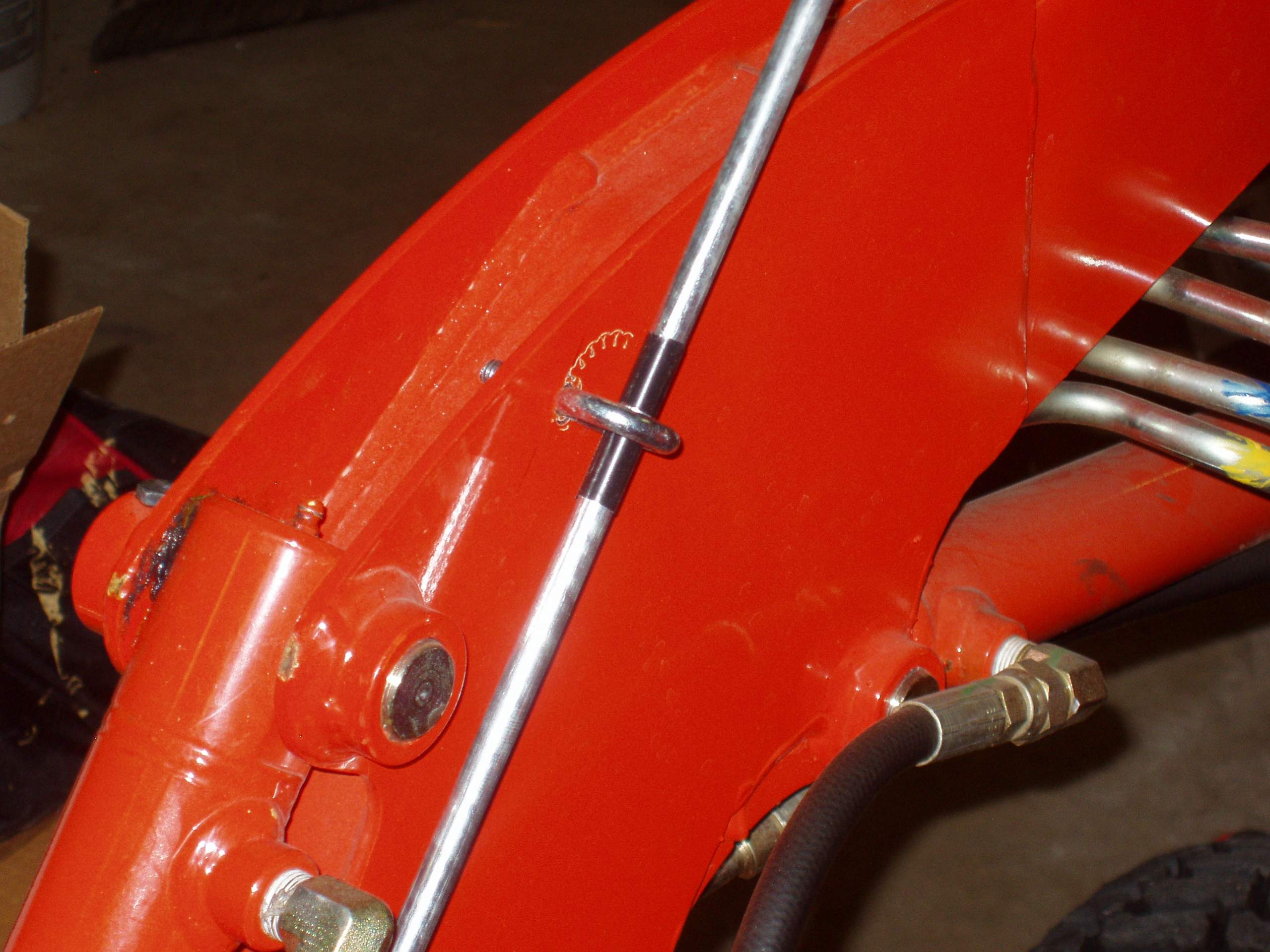

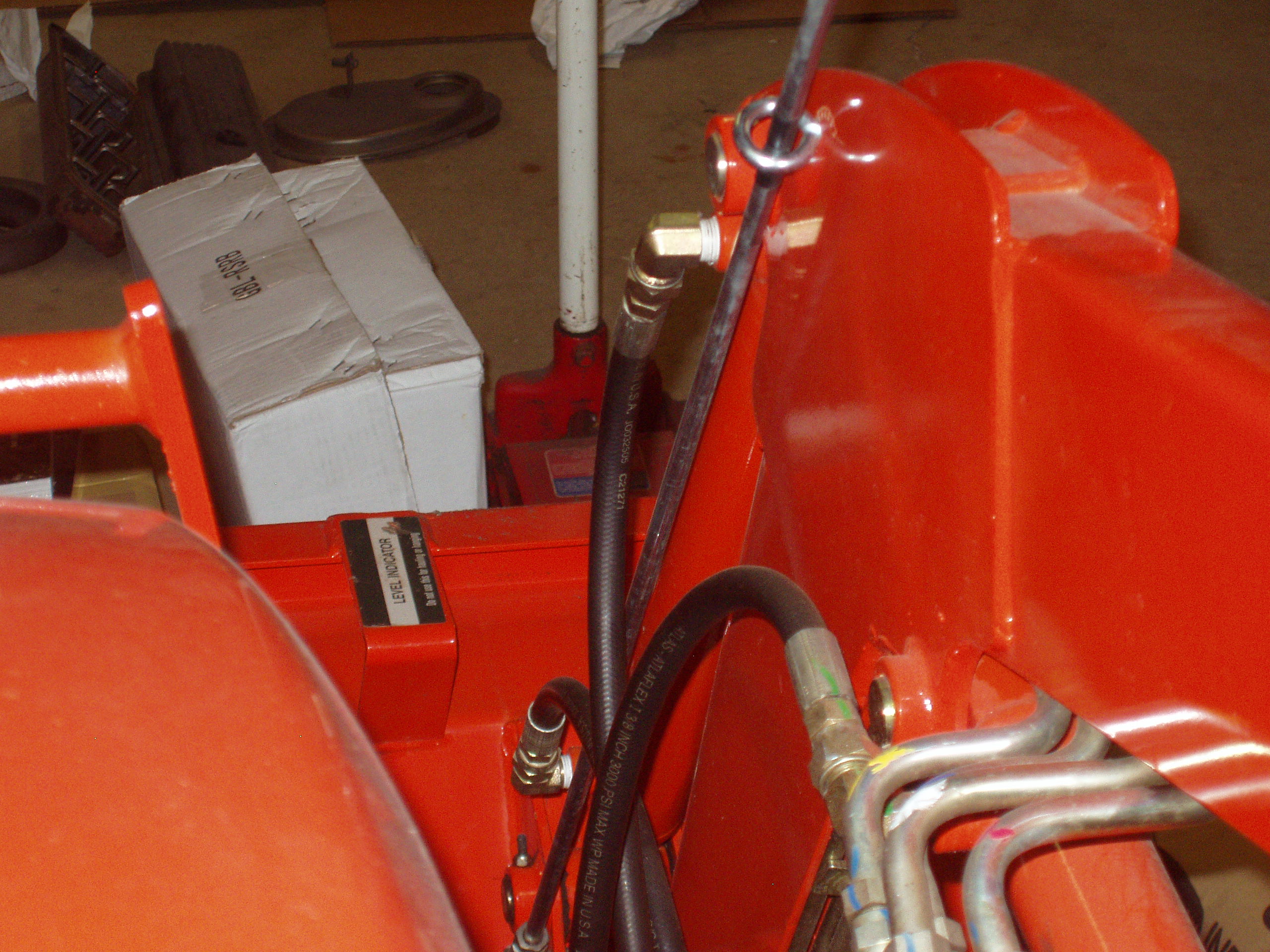

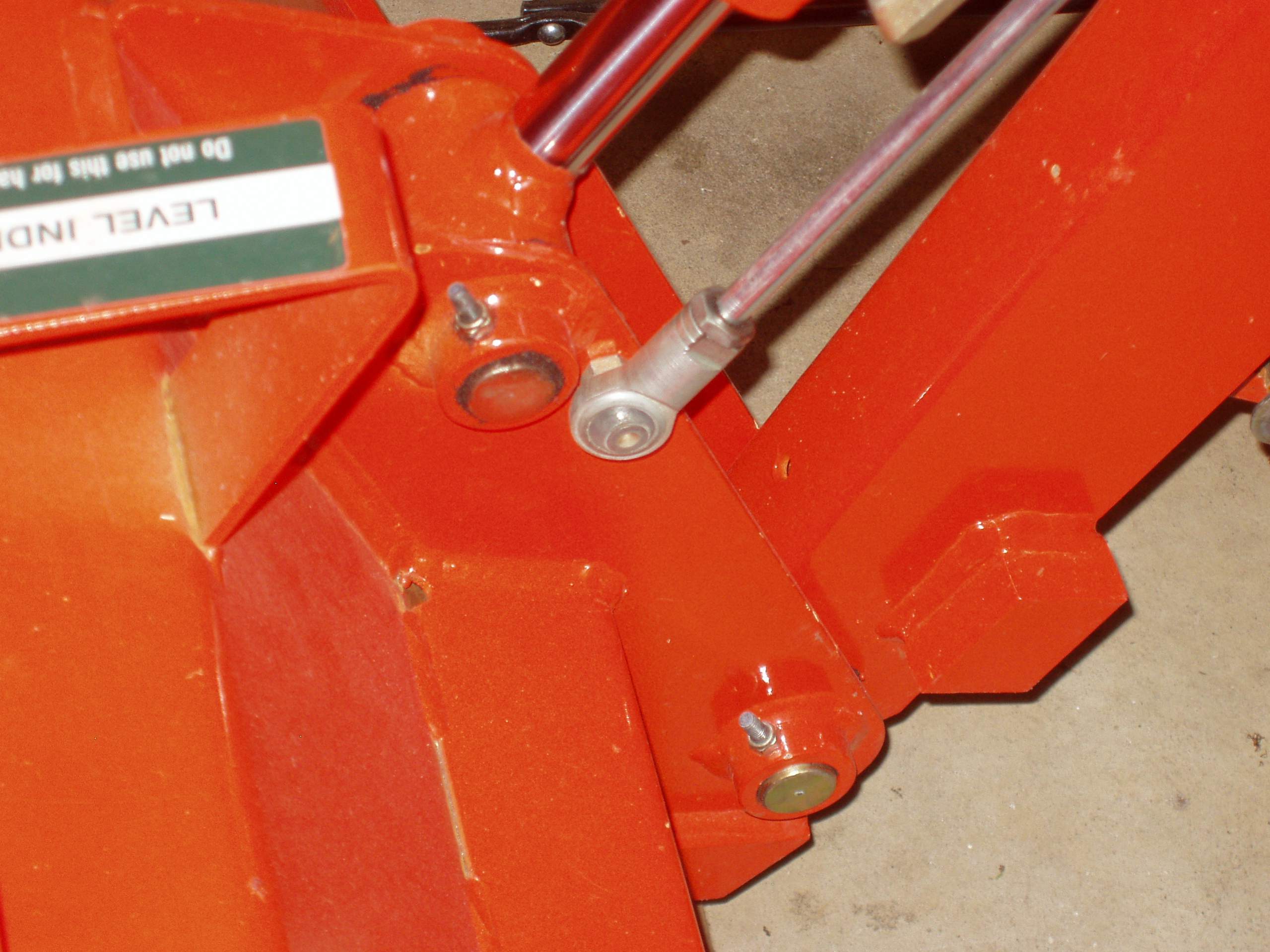

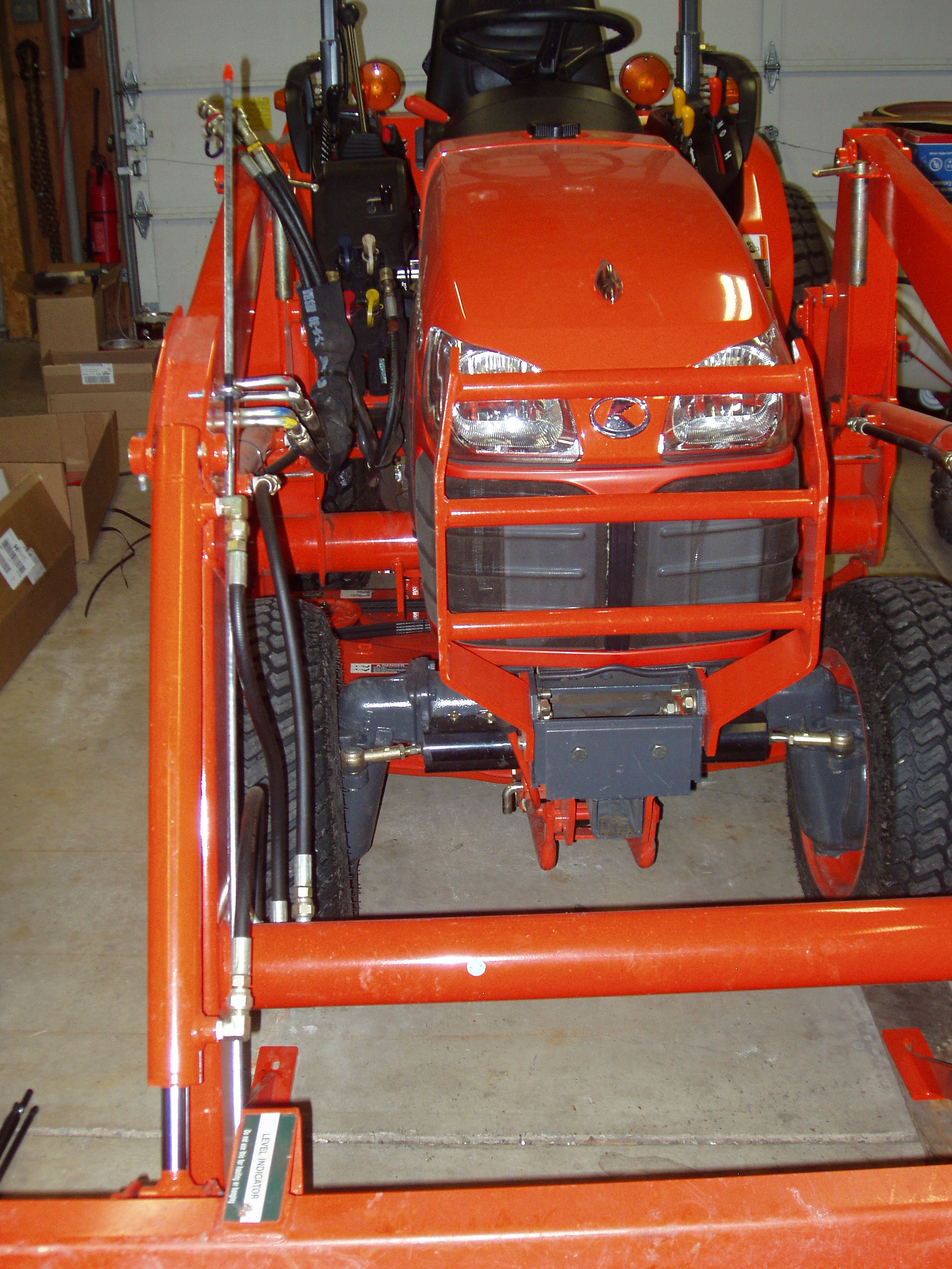

Here is what I did. I used a Heim joint on the bottom end but you could easily make it just as effective by bending a 90* angle on the end and use a cotter key to hold it. The top is a hardware store eyebolt. The rod is 3/8". Not my idea. I copied it from a Woods loader I saw.

Very nice. Take a stroll or even sashay over to your Kubota dealer and see how Kubota has changed the level indicator from the LXX30 models, pretty clever.
