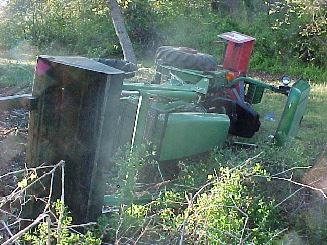

This is a picture I've hoped never to have the opportunity to post.
My neighbor wanted some scattered brush piled for burning. I was glad to oblige. The brush was not thick, but it was tangled. With loader raised, on fairly level ground, the forks had some bush caught, so I backed slowly to break it loose. The left rear wheel fell into a hole (didn't know it was there) and I felt the tractor start to tip. I knew to lower the loader, and even though the roll was slow, I couldn't get the loader down fast enough.
My seatbelt was snug, and really did it's job. I had no injuries. My pick-up had no trouble righting the tractor. After topping off the fluids, I drove my tractor home and gave it a bath. I needed a bath, too.
As with Steel Wheels, the left side ROPS light popped out, but popped back in and works fine. The canopy wasn't damaged (amazingly), but the brackets that hold it were bent. They straightened without too much trouble and the canopy is now reinstalled.
I've always been a bit on the high maintenance side for my guardian angel, but once again he came through.

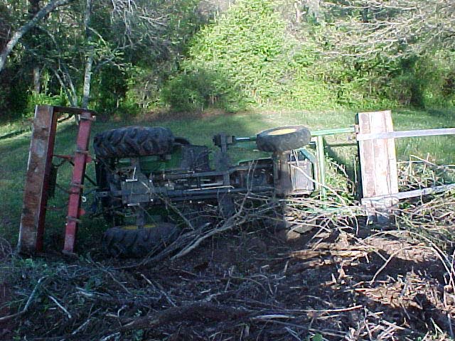

Another picture.
You can see from this shot that the FEL is raised some, but only about even with the hood of the tractor.

Yikes Okie, glad you are OK! That's a pretty scary looking predicament that I hope I'll never have to go through. Thanks for giving us all a not-so-gentle reminder of tractor safety /forums/images/graemlins/smile.gif

That's a new way to check out the bottom side of the equipment . Most people just crawl underneath with a light.
Glad your safe and sound and do put in some statements on the seat belt and rops.

Didn't having that box blade pushed over to one side damage one of the lower 3ph arms?

Kind of hard to tell from the photos but it looks like not enough rear ballast for the FEL and forks. Those long forks put the load center way ahead of the design so you have a much lower rating on the FEL. How deep was this "hole" you backed into ???? I can see wheel weights, are the tires loaded ???? Most tractors I have run with a light load in the bucket that close to the ground will take a pretty good dip at low speed. I had a 43hp Case with a boom on the bucket, loaded tires, weights AND a 1200# weight on the 3PH to handle 300# safely.
