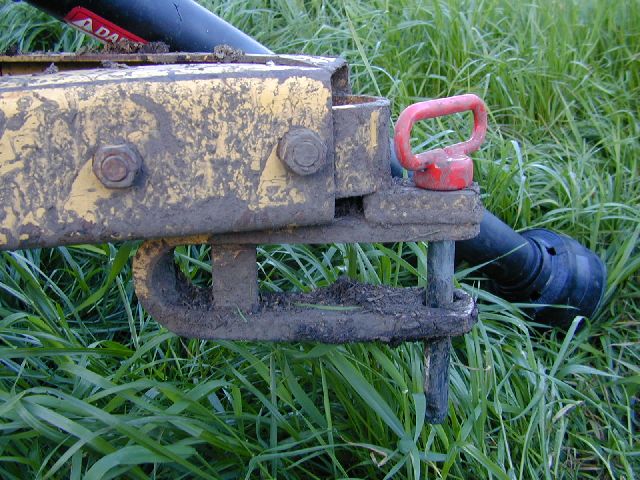

I use about every piece of farm machinery there is and I have never had a hitch pin come loose. Any way to post a picture of the hitch pin you are using? I just can't believe that the keeper would break. I'm not saying it didn't just that I don't see how it could.
   / Anouther problem with hitch pin #4
I agree with Cowboydoc; never had one come unhitched and need to see a picture of what you're using.

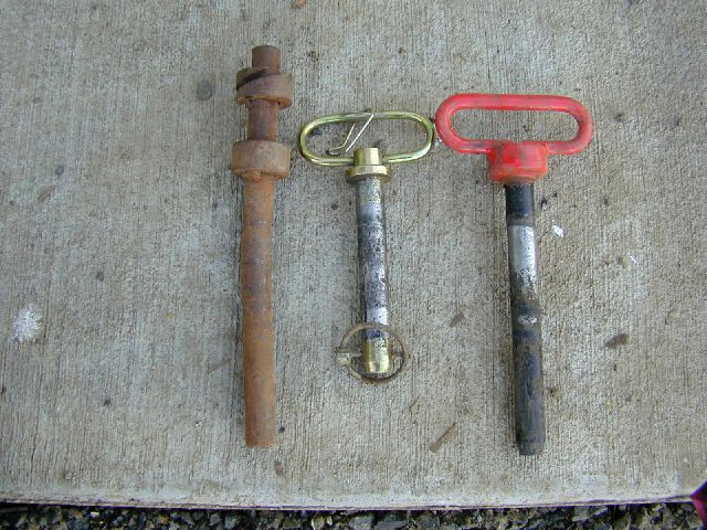

So I did kind of assume that the pin broke off. It was connected to the hitch pin with a chain, which did break. It is possible that it came off while driving around the manure pile. I was at work when I posted. I know better that to post without pictures but what could I do.
Anyways the attachment is the hitch pins I used. Left to right in order. The last two had ¼ inch cinch pins connected to them as keeper pins.

This is a picture of the pin in the hitch.
Eric

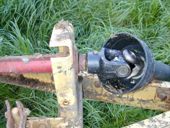

This is a picture of the shaft that was bent when the spreader rammed into the tractor. I need to fix it yet. It wobbles.
Eric

Were you in a corn field where the corn stalks could have ripped the cinch pin clip loose? I have had trouble with losing them when in the woods, and have replaced most with short bolts and lock nuts.
There are hitch pins that have bails and things on them, and found at farmers' stores. Not good to have a pin come out and they can work themselves up when the tongue begins to bounce. We used to tie them with bailing wire, (like the coat hanger that was mentioned) but sometimes they can be ripped off too. Goes with the territory - if you are active and working, things will happen. /forums/images/graemlins/confused.gif

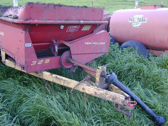

This is a little bigger picture my old manure spreader.
Eric
