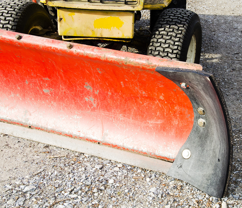

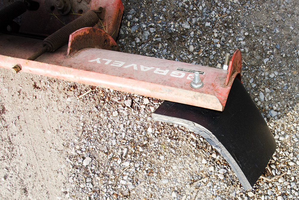

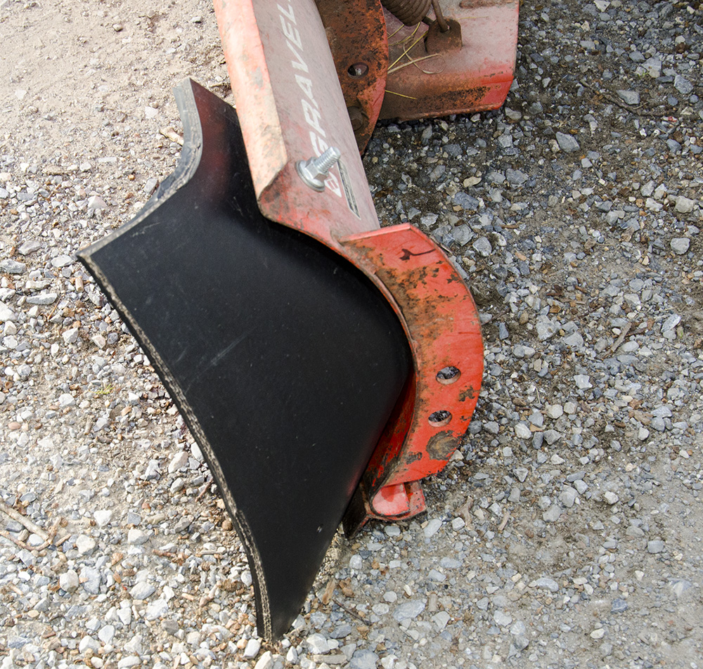

I built extensions for a blade that I had,, back when,, I used 3/4" thick belting rubber,,
The hardest part was making holes in the rubber, a regular drill will not drill that thick rubber.
I found a drill powered gasket cutter set at HF,, that cut a plug out of the rubber, that looked like a 3/4" thick black color "Tums" antacid tablet,
When the rubber was bolted on with compound curves, I think the wing was approaching the strength of the steel blade,
That extension would bend at the very tip, but, the main part of the blade never bent.
That rubber becomes amazingly strong when curved, and more than double that strength when curved in two directions.
The nice thing is the rubber is easy to cut, and the bolt holes were easy to drill in the blade.
My neighbor has been using that tractor/blade for over 5 years (and that is after the years I used it)
He is so proud of it,
