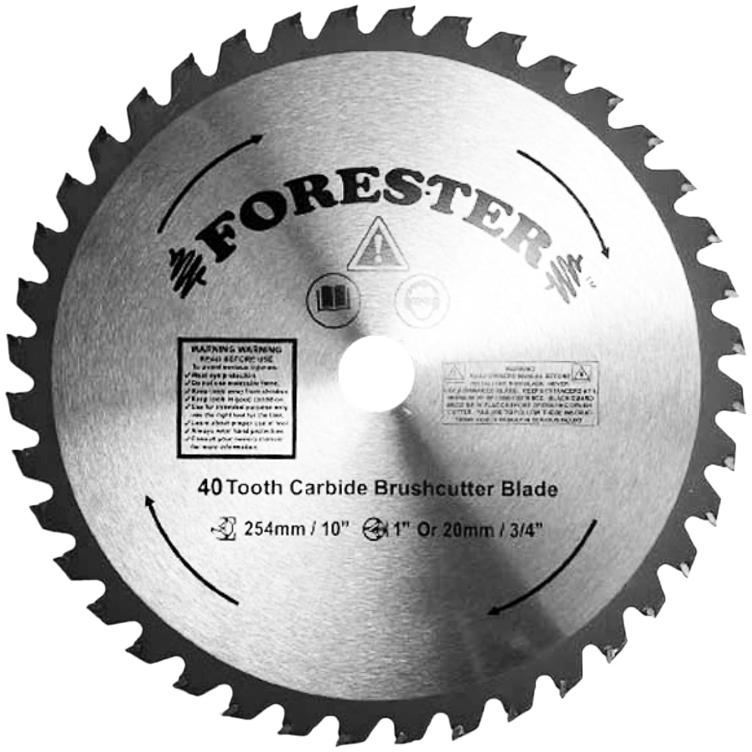

It would be interesting to try one (although I'm big into DeWalt). My experience with blades on a few different platforms has been less than great. I have a blade for the Stihl Kombi that dulls very rapidly. The shape of it is less like the propeller in the link you posted and more like a disc with lobes. There's another failed one from a previous whacker. I made an adapter for a carbide circ saw blade once. With the weight of the blade, it took a while to get up to speed. I waved it at a sapling and there was a "ding" sound as though someone tapped the blade with a tiny hammer. The sound was the only indication that it had zipped through a sapling that seemed to represent the bones in my lower leg. I shut it down, removed the blade and never put it back on.

I have the string trimmer and I put a Milwaukee brush blade on it and it cuts plenty good enough to suit me, I think when used within reason you would be satisfied.

With the tri-blade it will snip through 1" stuff easily, barbwire too!
I've cut 3" stuff with it too, but it takes a few "wacks" to get it down!
It's reversible, and re-sharpenable too.
