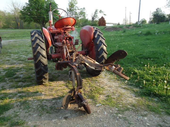

Only to plow my little 1/4 acre garden. I have 2 different OEM IH Fast Hitch plows for the Super C Farmall's I have. Since there is some slope to the garden, I roll the dirt uphill, plowing one way. It also eliminates having a dead furrow to contend with. One plow is a C11, 16" single bottom automatic rollover plow, aka/Hillside plow, with Plow Chief bottom, my cousin got for my Dad, probably 40 years ago. It laid out back, never used until about 5 years ago, when I decided to get it working, and let it earn its keep. It takes about 20 minutes to hook the connections up, to make it flip, plus removing the PTO guard,and same amount of time to remove it. So it depends on what's going on here, if I have the time to hook it up to use.
The other is a standard 2 bottom 14" Fast Hitch plow, with the Plow Chief bottoms. This one, you can just basically plug & play. Setting the level for a flat bottom, and nose pitch to run level once the first 2 passes are made, are hydraulically adjusted through the hitch mechanism, so it makes it quick and easy to get things adjusted.
Both do a decent job of plowing, and do a great job of turning over last years mulch/debris, to make a nice planting surface. Below is a short video of the auto flip plow, doing it's thing. Saves a lot of deadheading, when you want to roll dirt in one direction.
Automatic flip video 002 - YouTube
