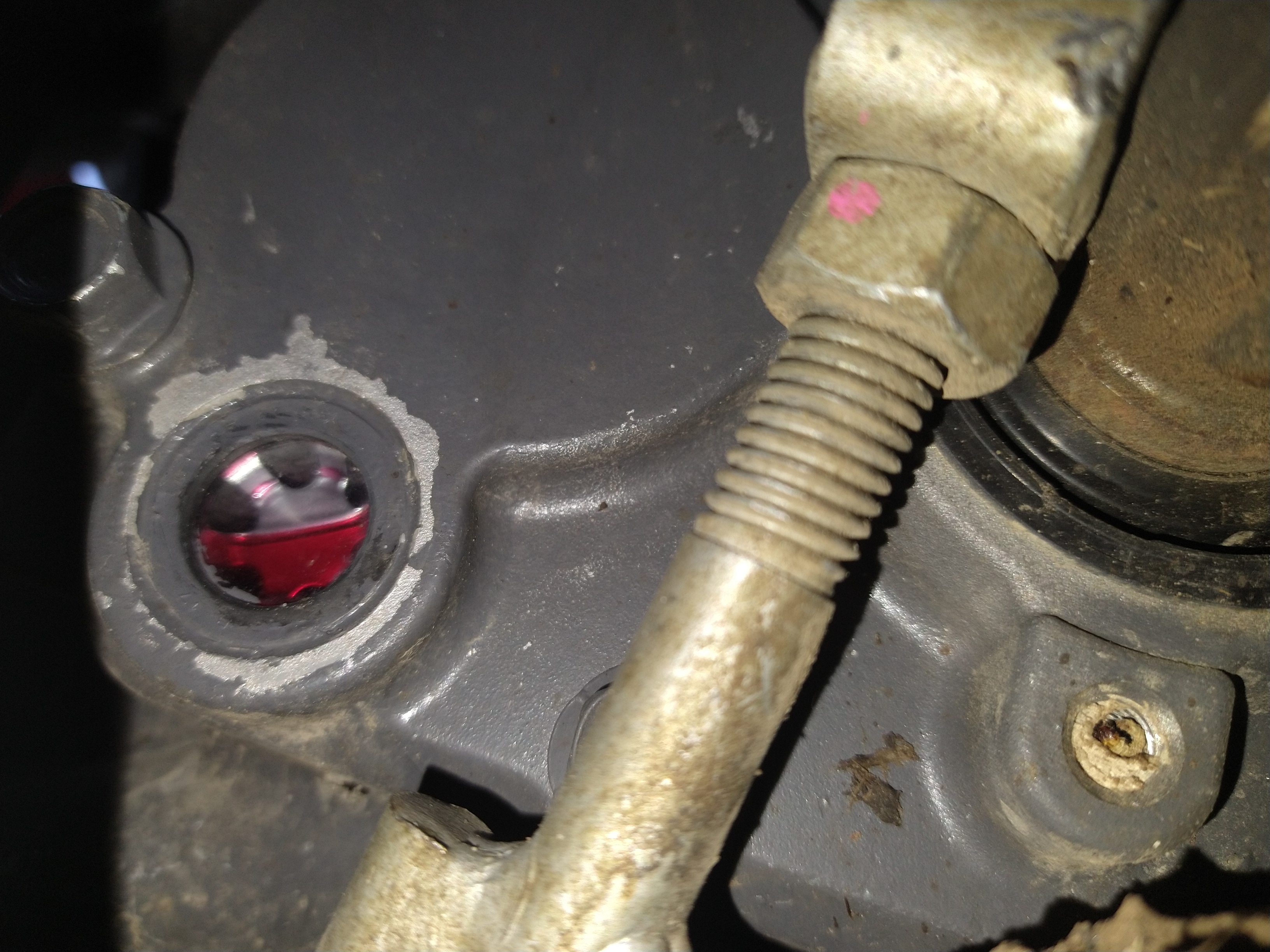

JD sells it, it's expensive per ml, you might get 2 fills out of it but they suggest it's for 5 gallons (if it's pasty or dried up, add hydraulic fluid and stir!) ... I bought mine from https://www.zoro.com/kingscote-dye-...red-4-oz-506250-r4/i/G5130815/#specifications (I bought some gloves also to bump total up to get "free shipping!")
Wear gloves, I recommend pouring/dripping it into the jug, then pouring into tractor ...
2 drops per gallon ...

I use the JD dye. It works, turns the oil red. Does not take much. My L3600 has a sight glass, could not see the oil without the dye. Easy, just pour it in. Might mix with some of the oil to pour easier.

I can see my fluid in the glass fine in the daylight, but in my shed at 5am it is like a cave and I only have.... the equivalent of a 60W bulb that does not give me light enough to see the fluid in the glass and my flashlight and drop light both cause too much glare on the glass to see un-dyed fluid. With the red dye I have none of these issues.

I’ve never had an issue with a sight glass if it was properly filled. If the level isn’t within glass it can be hard to know if it’s low or high. The tube glasses are better in that aspect but some sight glasses are only about the size of a quarter. My skid steer sight glass has a ball that floats in the tube that fixes that issue. I also carry a pocket flashlight that I probably use 50 times daily.
Forgot about too low or too high. But there might be other indications that caused one to look. Maybe.
