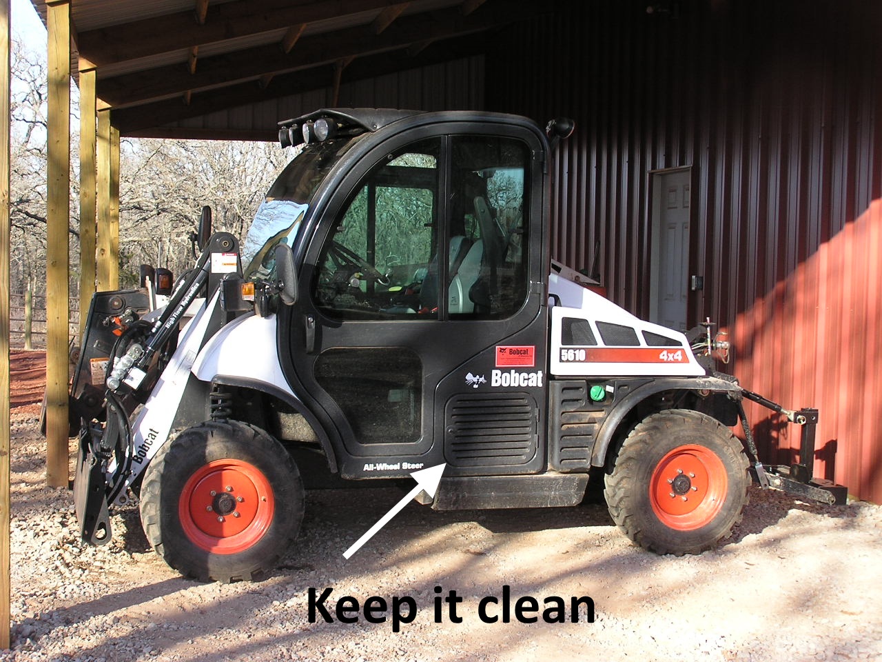

Don't know how the D Series is set up, but on the F, if the condenser coil gets plugged with dust and dirt, you have no cold air.
The F Series also has an electric fan behind the coil that has to be working, or no cold air.
   / Anyone Have Air Conditioning Issues? #6
Good point. Always make sure the HVAC filter and condenser coil is clean.
