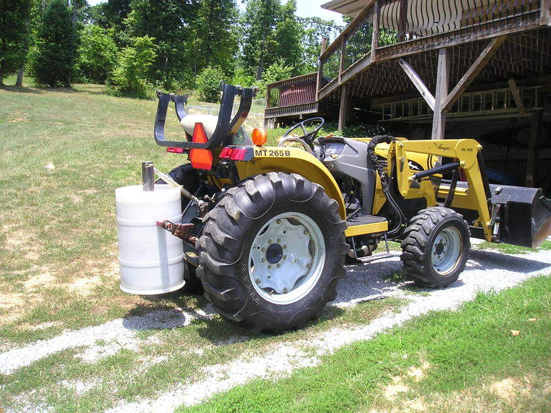

tractor005.jpgHere's a picture of the ballast I built from a plastic barrel filled w/concrete. I used a flat drawbar welded to a piece of square stock. The weight is around 450-500 lbs. Being as to how it's a plastic barrel I can take it off my tractor a slide it around on a concrete floor and push it in the corner when I'm not using it. Since that picture was taken I've been using a chain for a top link so should I drag the ballast box on the ground it will move a little bit instead of bending something. I also installed a 4" piece of PCV tube in the concrete to be able to carry an axe or sledge with the concrete several inches from the top of the barrel to carry a chain and some wedges. I also have a BX 2230.

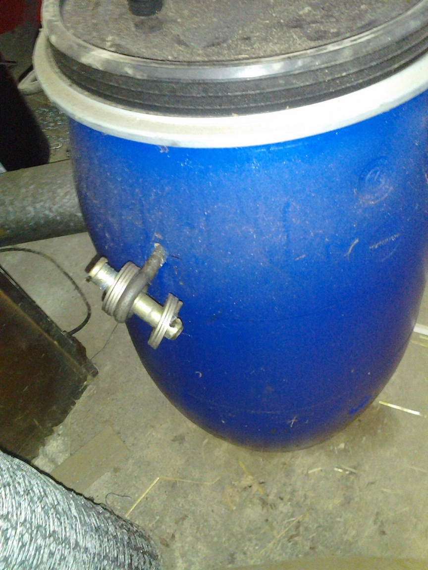

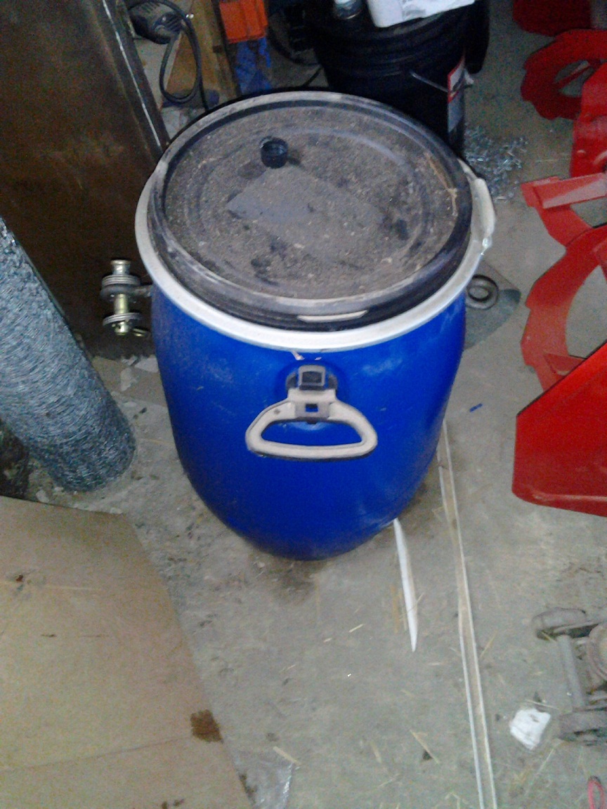

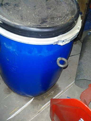

I made one like mehig has. I took a small plastic barrel, put 1 bolt thru the bottom that goes onto my cross drawbar(with a nut on the bottom), filled it with rocks, put a long turnbuckle near the top(for the tractor toplink to hook to), then dumped 2 bags of concrete on top, shook it to get it to drop down in some, then added water. I reinstalled the lid and it works great.
:thumbsup:
Pictures of mine. In the bottom, there is an old steel plate I had lying around that had a hole in it, I just put a long bolt thru it and out the bottom of the barrel. This barrel is 24 inches high, to the top of the lid, and is 15 inches wide in the middle.
