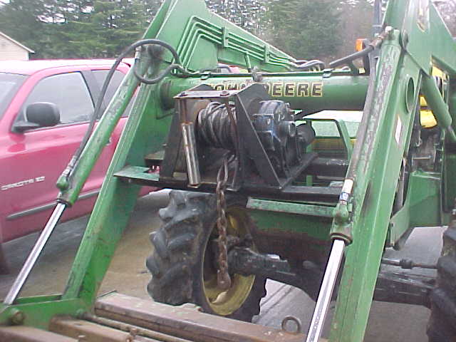

one more
   / anyone made a pto winch on 3 point hitch #12
the hyd winch

appreciate the pictures yep looks like that winch has made you some money. bout how much was you salein em for when you was. got a ole small electric warn m8274 an was runin it so hard it fryed the armature an them aint cheap if you can find one. i noed better but i had to prove myself right.
   / anyone made a pto winch on 3 point hitch #14
In 1981 I was selling the 8000 for 1250 and the 12000 for 1800. The big costs of course is the winch and driveshaft, if you can find something used you can make one pretty reasonably.
   / anyone made a pto winch on 3 point hitch #15
Those M8274's and old models are excellent winches, among the best ever made! The motors are available rebuilt from several places and the newer motors draw less power than the originals.
The newer winches don't have as good of bearings (if any) and the brake has to be worked against when power spooling out line which heats up the motor!
Ken
