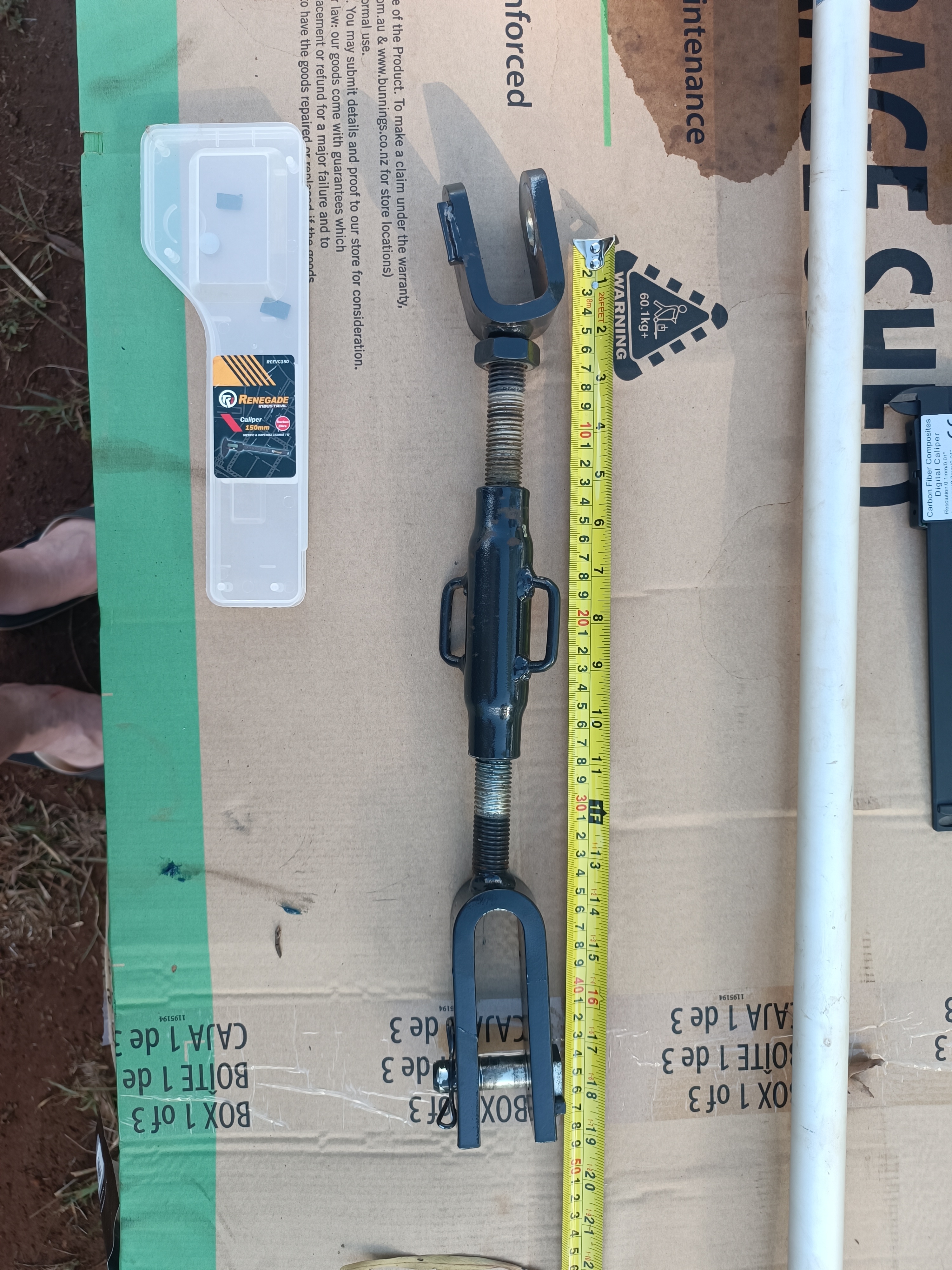

Hi all,
I'm looking at purchasing a top and tilt hydraulic actuator kit for my Bobcat CT2035 Tractor (I already have 2 remotes on the back). I checked out a few companies that sell top and tilts, and WR Long had the fastest reply and best match for the strange Bobcat side link (pic below). I haven't heard of the company before and struggling to find in depth reviews of the kits.
Is anyone using their top and tilt hydraulic kits? How's it been using it?
Really appreciate the info

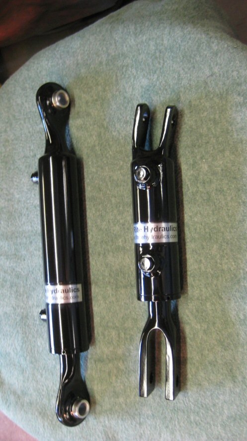

I just bought a set a few months ago for my Yanmar YM347. Both kits fit like a glove and were easy to install. I have plenty of range of motion and am very pleased at this point. I’ve only done small work with the box blade since, but got lots of road to do on ranch this late winter/early spring. Great folks to work with. It did take a while to get as they were back logged.

Hi all,
WR Long has been building T&T kits for about 2 years now. They build good kits, maybe provide hoses that are a bit long for some applications.
I'm guessing that you are from Australia?
If not, I'm happy to provide a quote.
