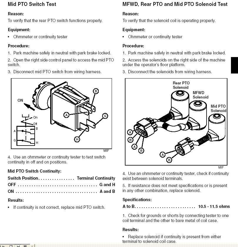

On my 940-hour Deere 4210, the mid-pto that runs the mmm is becoming very reluctant to engage. The drill is, you first engage the mid pto knob, and then the rear pto knob. I have been having to go through that process a half dozen times before the pto will actually engage.
Would anybody know what I need to check out first? Thanks.

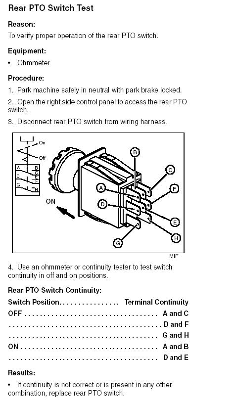

Here is a procedure to test the rear and mid PTO switch. I see the MFWD solenoid is involved as well. ??

Thank you very much for sharing that information with me....:thumbsup:

On my 4310, which does the same thing, it is the seat switch that is preventing the mmm pto from engaging. The next time sit down in the seat heavily and see if it makes a difference.
