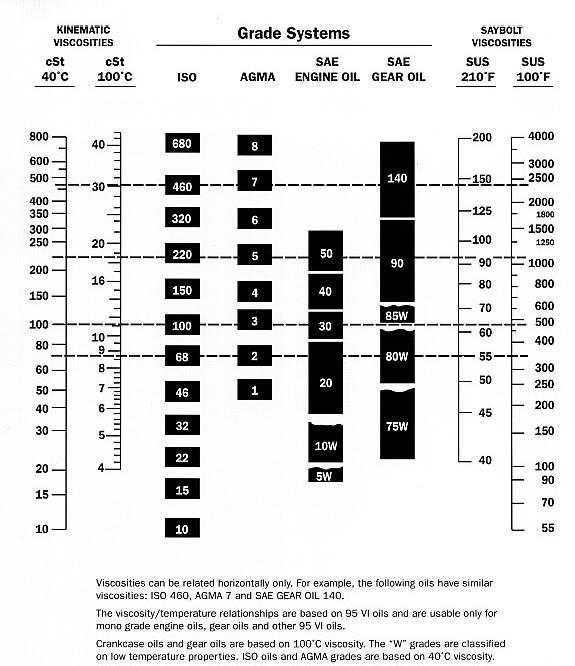

The technical answer is both. They are both 100w viscosity AND 30w. And no I dont mean multi-viscosity like 10w30 motor oil.
It has to do with scale. Hydraulic oil is ISO viscosity scale. Motor oil is SAE scale.
10w motor oil (SAE scale) is equivalent to ISO 32
20w is a broader range that encompasses both 46 and 68 on the iso scale
30w on the SAE scale is the same as 100w on the ISO.
Gear oils are different too.....
Sever charts out there but something like this might help What is Oil Viscosity? | Comparative Oil Viscosity Chart

Excellent, thank you.
I was really scratching my head thinking that a viscosity of 100 (I'm accustomed to SAE) would be pretty darn thick for this....
I had no idea there was a different scale.

It's really this simple .. o_O
