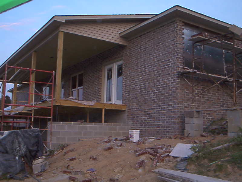

Thanks for the note, Eddie. My post was basically just a note to say that I am very thankful that my GC on my house is so diligent in making sure everything is right. I really admire OBED in having the time and patience to rework all the stuff that has gone wrong.
The only problem I have had with my house has been with the plumbing height of the body shower nozzles in the MBR and he corrected it at no charge, even though it was my brother in law who gave him the location to put them. They were too high and would have hit my wife directly in the face. He admitted that he thought they were too high, but had the plumber put them where my rep said to. He also put in lots of extra wall sockets and 3 way switches to control all the lighting and be able to turn them off without recrossing the rooms. All this extra was no extra charge also. Not many contractors do that kind of work which is why he is in demand in the Hot Springs area of Arkansas. I attached a progress photo of my house which was started March 3, 2010 and is in the bricking stage now. We are waiting on cabinets now on interior, so I think it is coming along pretty fast. Completion date is scheduled July 15th. with move in no later than 25th.
