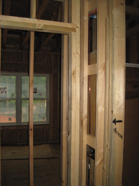

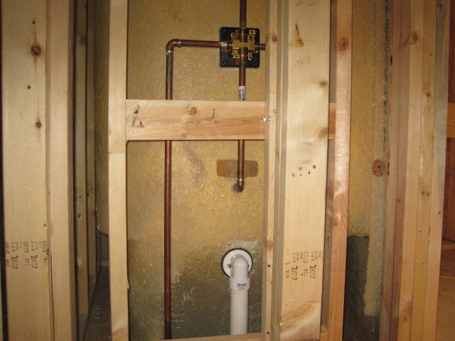

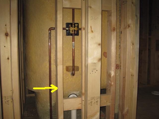

Planning for Future Shower Plumbing Repair
Last night when looking at the plumbing for the hall bath shower, it occurred to me that if we ever needed to repair the plumbing for the shower, it would be a royal pain to access the plumbing. I figure the shower fixtures will leak at some point; it's just a question of how long it will take.
The first picture shows the shower on the right and a bathroom closet on the left. Here's a closer view. The yellow arrow shows the stud that would really be in the way if we ever needed to repair the plumbing later. The horizontal blocking is also in inconvenient spots.

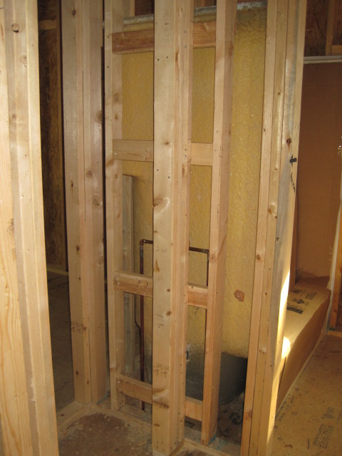

Today the framing crew moved the offending stud to the left and repositioned the horizontal blocking per our direction to provide more convenient access to the plumbing.
We are on the slow track to building the house. Had we been on the fast track, we would likely have missed a lot of stuff like this when it could be easily changed. We are fortunate that we had a delay in starting the brickwork. The delay enabled us to catch the improperly installed doors. If the brick had been installed immediately after the walls were framed and drywall had been quickly installed, we would have had trouble with all our exterior doors for the lifetime of the house. Living in the camper is not ideal but it has some advantages because we don't have to be in a hurry and we can inspect things a lot closer since we are always here.

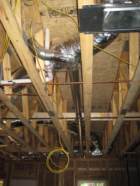

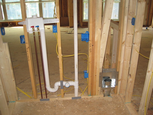

The dryer vent ductwork got installed Friday. I am very happy how it turned out. It's straight as an arrow and slopes so it will drain outside. Of all our vent ducting, this is the one I wanted most to be installed well because it seems to be most likely to cause problems if not done right. Per earlier discussions in this thread, water will condensate in the ductwork and will collect in low spots if there are any. The resulting pools of water will cause the lint in the dryer ductwork to collect in the wet areas and eventually clog up the duct. We have a long run from the laundry room to the back of the house so this ductwork needed to be done well. I'm very happy.
