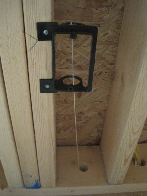

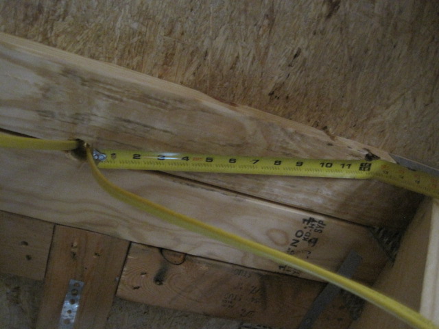

Low Voltage Boxes
Yesterday the wife and I installed 16 empty low voltage boxes for the computer network, phones, etc. We drilled holes through the floor and dropped strings in the holes. I used the existing electrical wires running through the floor to help deterine where I could drill. I went down to the basement and verified I wouldn't be cutting through anything bad before drilling any holes. After we are in the house, I will run Cat 6 wire as I need it and have time. Someone in this thread suggested that I could install the boxes and string now but run the wire later. That was a great suggestion. Thanks.
Here's where we have low voltage boxes:
1 box in DR/office wall below window
1 box in DR/office closet
3 boxes in BRs (1 for each BR)
1 box in MBR walk-in closet
1 box on left side of FP
1 box on right side of FP
1 box for desk in LR
1 box under LR windows
1 box at breakfast nook
1 box beside kitchen/garage door (alt. kitchen phone location)
1 box on kitchen bar
1 box at kitchen counter (phone and/or computer)
1 box MBR toilet
1 box hall toilet
In addition, we have already run cat 6 cable to the front porch and the back porch.
When we run Cat 6 wire, we will run 2 cables at a time to any box. We can put up to 4 network jacks in a box. We ordered two 1000 ft boxes of Cat 6. It is as easy to pull two wires at a time as it is to pull one.
I had considered hiring out running the Cat 6 cabling but decided against it. I just don't think I would be satisfied with how the work would be done. There are specific rules about how close to run the wiring to existing electrical wires, etc. in order to prevent network noise. I'd rather run the wiring myself to make sure its done the way I want it. For example, here's how the electrician ran Cat 5 cables that go between the garage door openers and the control box. While running the blue Cat 5 wire right beside the yellow electrical wires might work for a garage door opener, that's a no-no for network wiring.
We finally decided on a location for the low voltage patch panel. In our foyer area, we have 2 closets right beside each other. I'm not really sure why the wife designed 2 closets in the foyer but that is coming in handy. One closet will be a coat closet. The other closet is partially filled with a H&A return duct. We are going to put the patch panel in this closet which I am calling the vacuum cleaner closet. The closet is more centrally located than the closet in the dining room/office. It also is on the main floor so humidity will be less of an issue than in the basement. We have easy access through the floor to the Cat 6 wiring in the floor trusses.
We also picked a sub to run the security wiring. He starts work on Wed.
