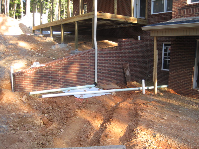

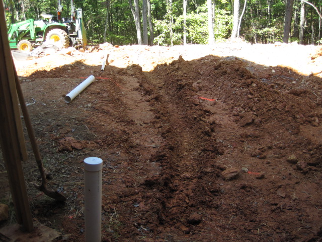

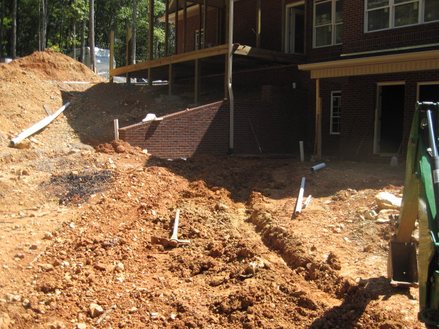

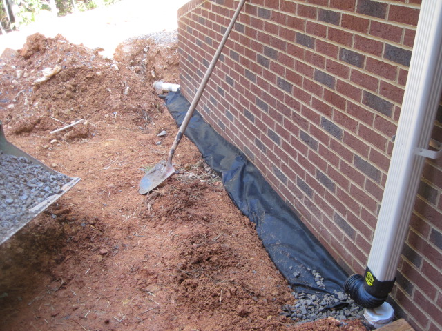

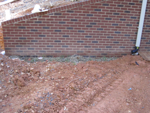

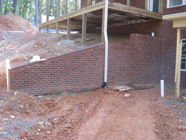

The weather here has been fabulous. Lows in the upper 50's and highs in the low to mid-80's with low humidity. Today I prepped a spot for the H&A unit pad. I also dug a shallow trench to drain water away from the back of the house.
I started off by putting some gravel and landscaping fabric along the retaining wall to provide a French drain to the end of the retaining wall. Next I dug the shallow trench. The water in this area now has a route to leave the house. Part of this area is always shaded so the clay near the house has not been drying.

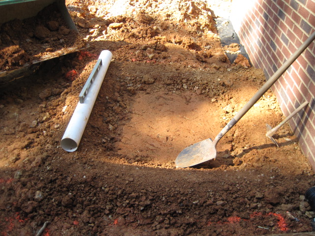

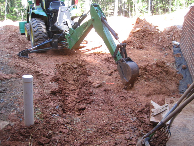

The pad for our H&A unit won't be nearly as nice as the one that CurlyDave poured. We're going to buy a pre-made 4'x4' pad. They cost $59. For me that's worth not having to form up and pour the pad myself.

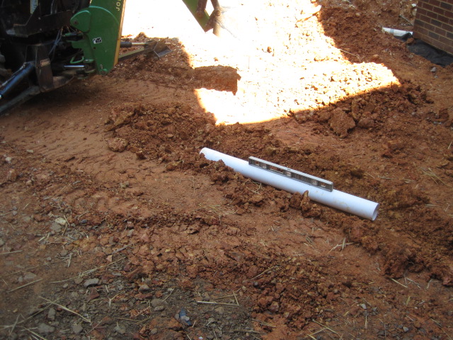

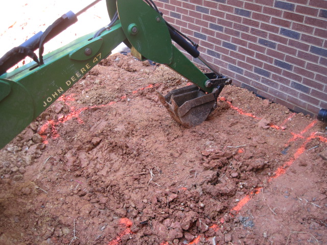

The first thing I did was mark the area with paint. I made some lines 12" outside the perimeter of the pad and also marked lines the size of the pad. I used the backhoe to compress the ground. I also hand tamped it with my tamping bar. Then I made a dirt "form" to hold the gravel. I used a plastic pipe under my level to make my level longer. I filled the area with gravel and hand tamped it and leveled it. The pad drops 1/4" per foot to shed water.
To end the day, I covered the area with plastic to prevent rainwater from getting in the gravel. The uncovered gravel area would hold water like a swimming pool if it rained. My wife will go get the pad in our truck. The company said it weighs about 300 lbs. I plan to unload the pad using the forks that attach to the FEL.
I had a good day today. The weather was very nice. I accomplished one more task needed before we can move into the house. Tomorrow I get to take the day off. I enjoy working on Saturdays much more when I know I can take Sunday off.
