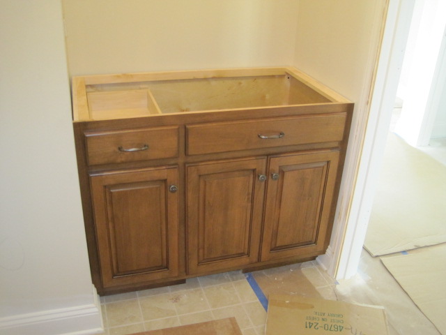

Here's the cabinet in the laundry room. It will hold the laundry sink. This is the only cabinet in the laundry room. We went the minimalist route for cabinets in the laundry room. We'll put some shelves up and a rack for hanging clothes sometime after we get settled in the house.

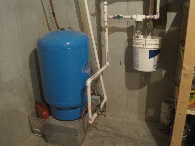

Water Heater Question
We are going to put in a gas water heater. The plumber asked us if we want him to use flexible water connections to hook up the heater to the copper house plumbing or if we want him to connect the copper water pipes directly to the water heater.
Does anybody have any thoughts on pros/cons for either approach? I don't have a clue which would be better.
Thanks,
Obed
Flex lines(copper type) for sure in my opinion.I have used them for 20 years or more and they are dependable and leak free. They also act as a union if you need to swap out the tank.

In our neck of the woods, our local code requires, flexible piping to the tank. A hot water tank expansion tank. A water heater pan beneath, and earthquake strapping to the wall studs behind. :thumbsup:
   / At Home In The Woods #2,339
Expansion tanks are often required with city water connections as they require backflow preventers to stop you from contaminating the whole system in the event of an oddball accident. Those stop any water from pushing back into the city lines, so as the water in the closed system expands from heating, it has nowhere to go and can over pressurize the system. On a well, you typically have a pressure tank for the pump that acts as an expansion tank also (at least functionally enough so). A pan is a darn good idea if the HW heater is not in a basement area, but the preferred method here is in the basement with a floor drain nearby.
Not too many seismic codes in other parts of the country to worry about...
   / At Home In The Woods #2,340
dstig1 is right on the money with both posts.

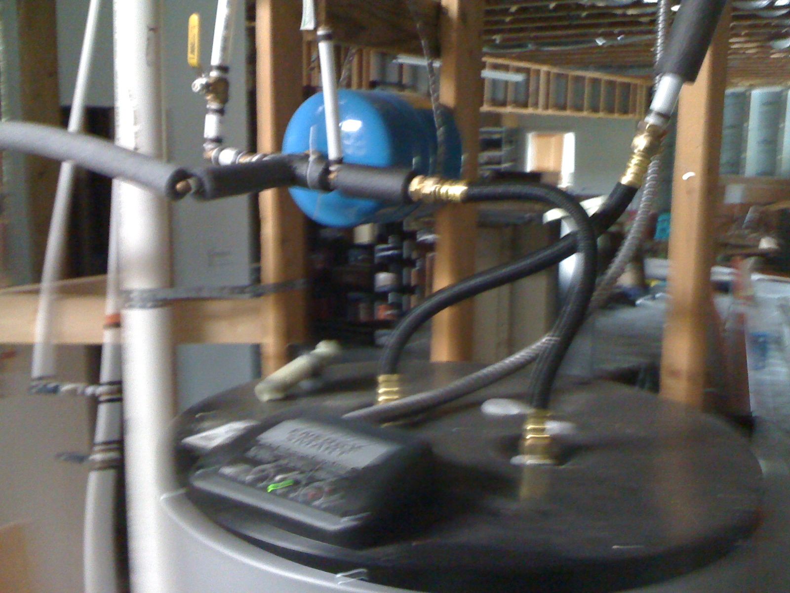

Our plumber (who I was not impressed with) used a flexible type of pipe on the hot water heater, here's a really bad cell phone picture of that. We are on city water, so we have the expansion tanks which you don't need since you are one well water and have the expansion tanks role done by your pressure vessel.

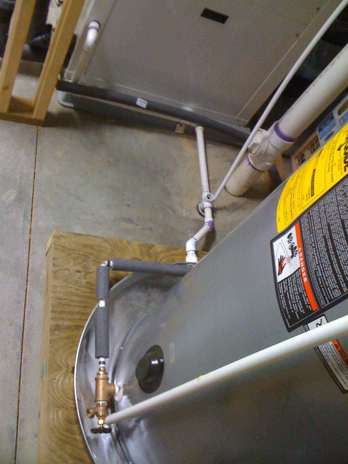

I put our water heater in a pan. I have gravity drains for the basement floor (in case of flooding from broken pipes) and run the condensate from the heat pump, the drain for the cold water line for the house (on a valve), and the drain from the pan with the hot water heater into it. Note that if you put the hot water heater in a pan now, even if you can't drain it you can someday put a water sensor in the pan and tie it into your automation system so you get an alert if there are problems.

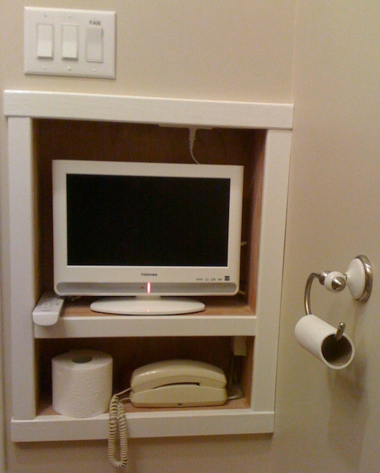

Good deal on the toilet paper access. Here's what I did on the downstairs half bath to hold the toilet paper and then some. This is what you face when you're on the throne. When our nephew goes in to use the facilities, we often don't see him again until the hour or half-hour :laughing:.
We only have "cat unraveling syndrome" if we put the paper on the spool the wrong way...
