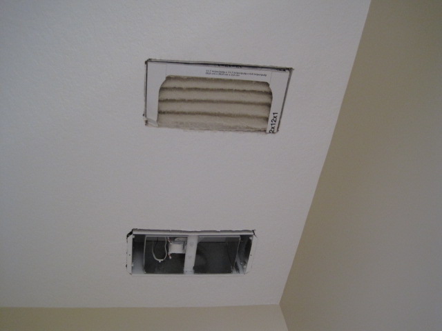

Obed, you're going to enjoy your Quadra-fire once you get it started. We put the same unit in our house and it really heats the main living space. We have an open floorplan so those areas are toasty. The master bedroom and bath do get cold because the furnace does not run as often.
WBWI,
Did you run any ductwork from the fireplace to heat other areas of the house?
We ran one duct from the fireplace to the hallway toward the end of the house where the bedrooms are. We also have an auxilliary H&A return in the ceiling beside the duct from the fireplace so the HVAC system fan can circulate warm air from the fireplace. We don't know if using the H&A return to recirculate heat from the fireplace will be very effective or not but we will be interested in trying it.
We also wanted to run a second duct from the fireplace to the dining room/office but the length of the run would have been so long that we might not have benefited from it. So we only ran one heat duct from the fireplace.
Obed

Obed,
I wish we would have run some ducting from the FP but we did not. Wisconsin frowns on tying the FP into the HVAC. I don't know why. We do run the circulating fan on the furnace to try and distribute some heat but it doesn't seem to help much. The FP will put off a lot of heat and I'm sure you'll appreciate it.

Obed,
We have a dedicated duct running from the fireplace to a register in the ceiling of the hallway. Beside the register we have an HVAC return that is also in the ceiling. So technically speaking, our FP is not tied to the HVAC. We'll have to see if this setup does any good. When my wife was researching fireplaces, people's comments online mostly stated that the fireplace puts out enough heat that they didn't need any ductwork running from the FP to other areas of the house. We strategically located our FP somewhat in the middle of the house and not on an exterior wall to make it easier to use it to heat the house.
