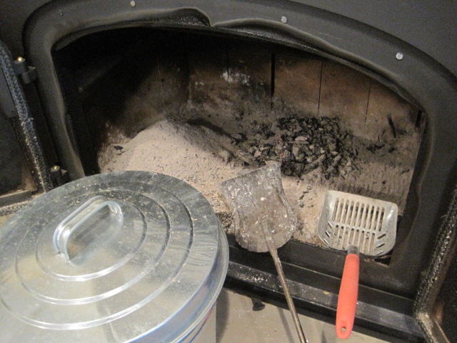

Using the perforated scoop helps to sift the ashes to separate them from the coals. We bought the scoop at a pet store. It was made for scooping stuff out of a litter box. After separating the coals from the ashes, I used the FP shovel to shovel the ashes into the bucket, only partially lifting the lid on the bucket to minimize how many ashes float into the air.

My wife does it because she has steadier hands and no we do not clean the stove out with the vac. She uses the fireplace shovel with one hand while holding the vac hose above the bucket.
ruralruss,
My wife tried this method of cleaning out the fireplace today and said it worked very well. She was able to use the handle of the bucket to hold the wet vac hose in place above the bucket which freed both of her hands while she shovelled out the ashes.
Obed
As in the article you mentioned, whenever we start a fire or reload the fire we let it burn until real hot before we cut off the air.

As regards coals vs vac... There is a commercially available metal bucket (5 gal I think) that you put upstream of your vac. It catches the debris before it goes to the vac canister. So if there are any coals they are trapped in this metal bucket where you may cap them off air tight so they go out for later safe disposal.
On my list is the job of a DIY copy of a small cyclone filter made of metal to safely vac live coals, essentially a metal version of Oneida's "Dust Deputy."
