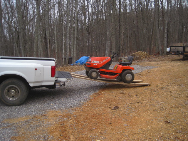

I've done it with 8' ramps (2x8's) on a friends JD riding lawnmower into my F250 (similar height to yours). Having some hill to work with helps a lot. I also have those steel ramp ends on the top of the ramps that helps a TON. Like these, only I just have the top brackets:
Insta-Ramp Steel Ramp Kit 8in., Tops & Feet, Model# RAMP1K | Ramp Kits | Northern Tool + Equipment
It's one of those things that looks so overpriced you tell yourself, "I could make that!" But then you don't get around to it for years and finally breakdown and buy them, and wish you had years ago... :)

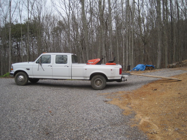

I made some ramps using the Insta-Ramp tops that Dave suggested. These things are great. We got the 8" wide version of ramp tops. When I looked at my lumber stack, I had 2x10 boards. The instructions say to not use a wider board than the ramp tops. However, my board only protruded 1" on either side of the ramp top so I think I'm ok. I don't think I would want to use 2x12 boards with the 8" ramp tops. The 8" ramp tops were about $25 for the pair; the 12" ramp tops were about $48 per pair. I didn't understand why 50% wider resulted in almost double the cost.
My boards are 9' long. I removed some wood slats from one of the boards. That board was used as a gangway from the ground to the front door during the house construction.
After finishing bolting the ramp tops to the boards, we went to the small engine mechanic's place and picked up our lawnmower that just got serviced. When backed up against a small slope, the angle of the 9 foot long boards was not steep at all. As the small engine guy drove my lawnmower up the ramps into my pickup truck bed, the boards bent way more than I liked.
When I got home, I parked the truck uphill of our garage at a spot that provided a great spot for unloading the lawnmower. You can see in the picture that the slope of the ramps was not bad at all. I did not trust the boards to support my weight and the lawnmower's weight so I did what clemsonfor suggested. I backed the lawnmower down the ramps while standing on the ground beside the ramps. I steered with one hand while I used my other hand to operate the pedal for the hydrostatic transmission. That method worked like a charm; it was really easy and wasn't scary at all. I even stopped the mower and took a picture of it while it was on the ramps.

You can see there is a noticeable bend in the boards, even with nobody on the mower. The bend was MUCH more pronounced when the service guy road the mower up the ramps. After seeing the bend in the boards with the service guy on the mower, I decided that I would have to attach a perpendicular 2x4 to the underside each of the ramp boards. However, after seeing how easy it was to back the mower down the ramps while I stood on the ground made me decide to just live with the boards like they are. The ramps would be much bulkier with the 2x4s attached to them.

   / At Home In The Woods #3,717
:laughing: just doing my part, Obed!
Seriously, reinforce those ramps. Either a second layer of 2x10 or a 2x4 or 2x3 standing on edge on the underside (the lighter way). Just hold it back from the ends a few inches or more so they don't interfere with the ground or truck bed.

   / At Home In The Woods #3,718
Stop by the metal shop and pickup 4 (at least 2) 1.5 inch wide strips of 3/32 or 1/8 flat steel. Drill holes every 8" centered. Attach to at least one side of each ramp. That will make it nice and solid without adding bulk (and not too much weight).

#3,719
Depmandog,
Have you been talking to my wife? She suggested something very similar. Are all you guys trying to cheat me out of my getting a utility trailer? Right now I can tell my wife that those ramps are too dangerous, that we NEED a utility trailer. I already took Dave's advice and am now on shaky ground. If I go to the metal shop, I'll never have a utility trailer.
