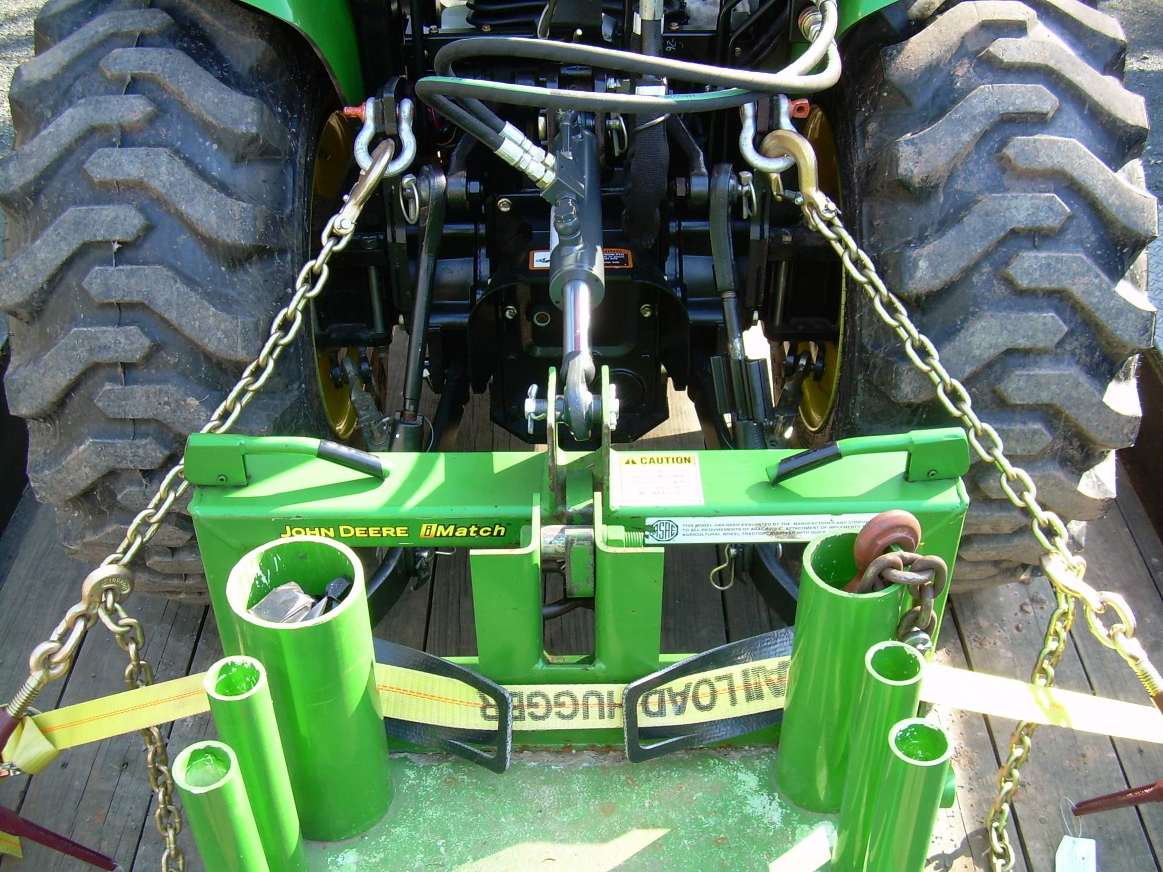

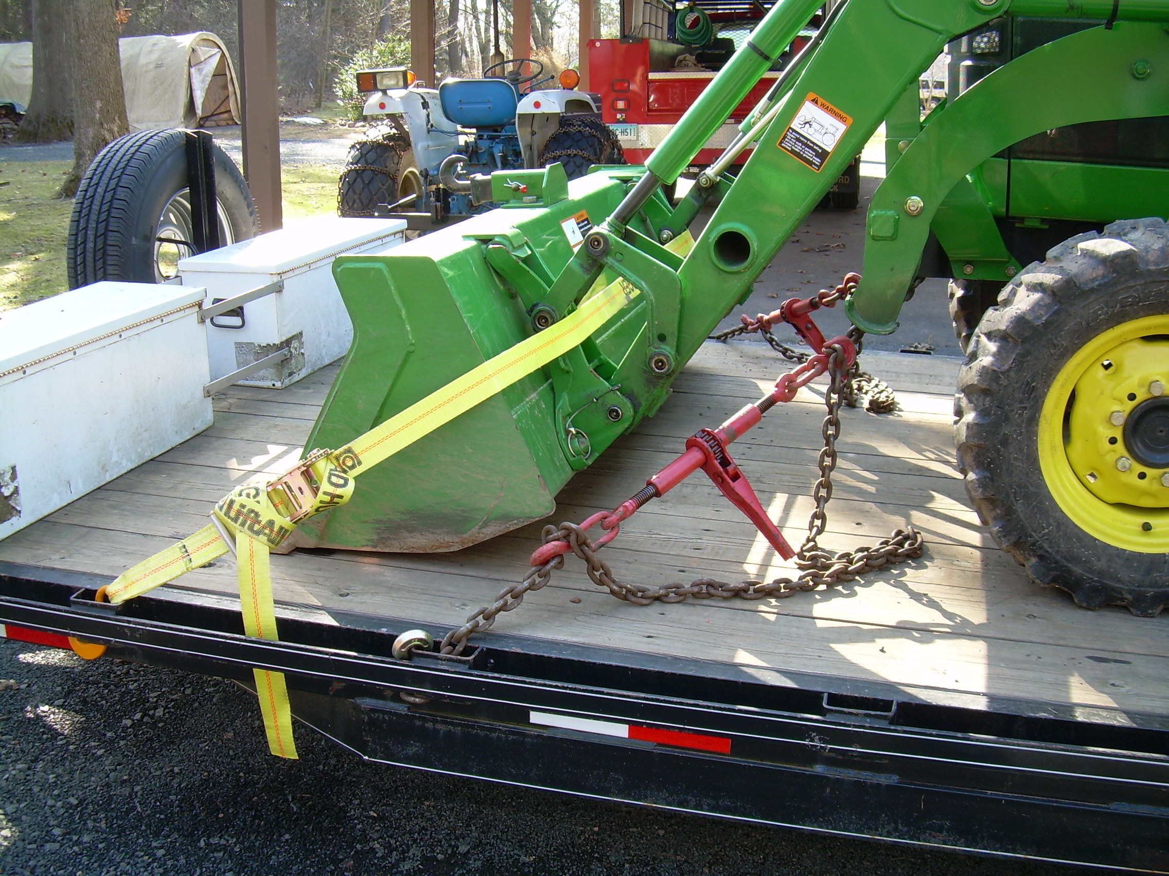

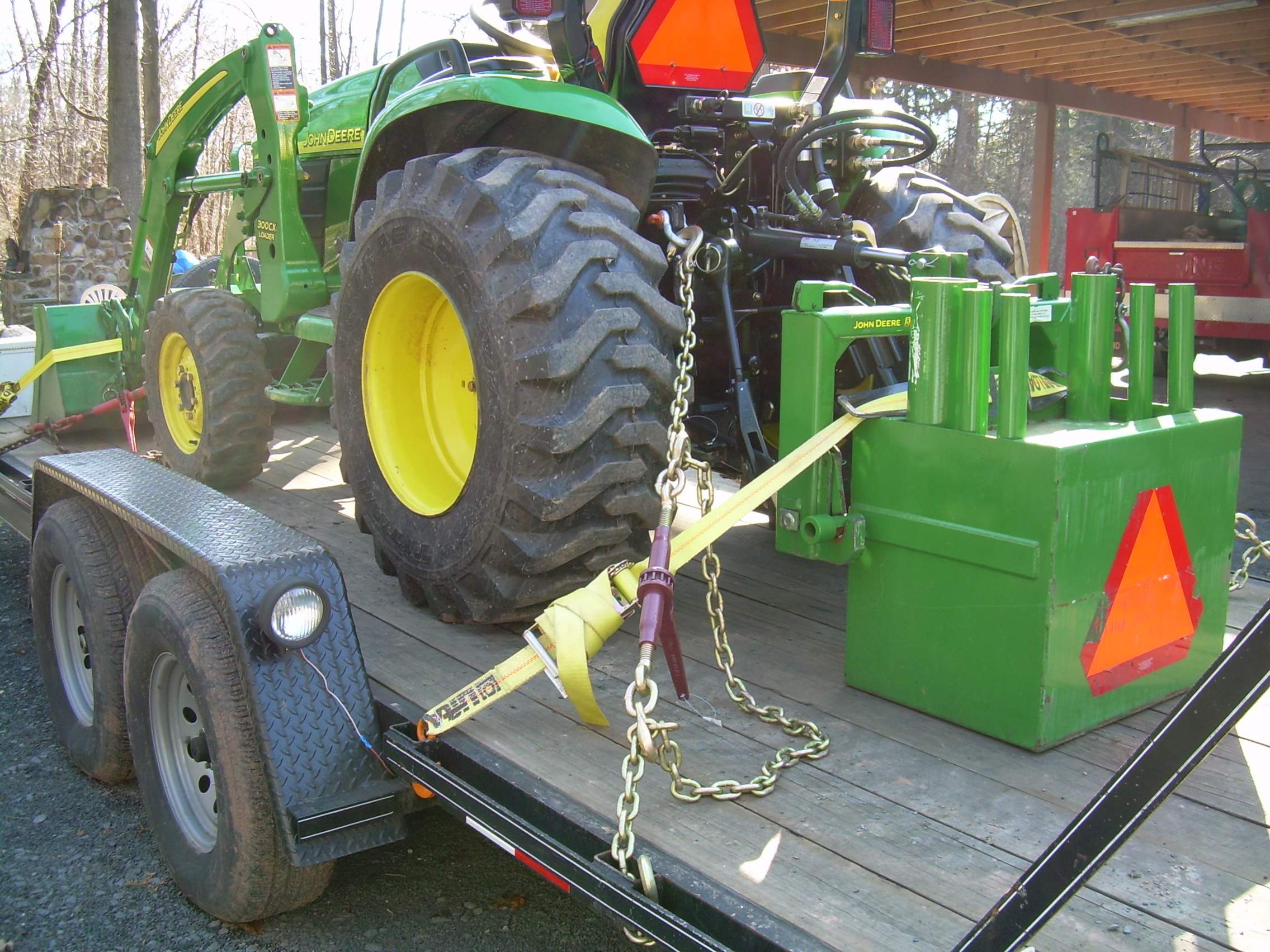

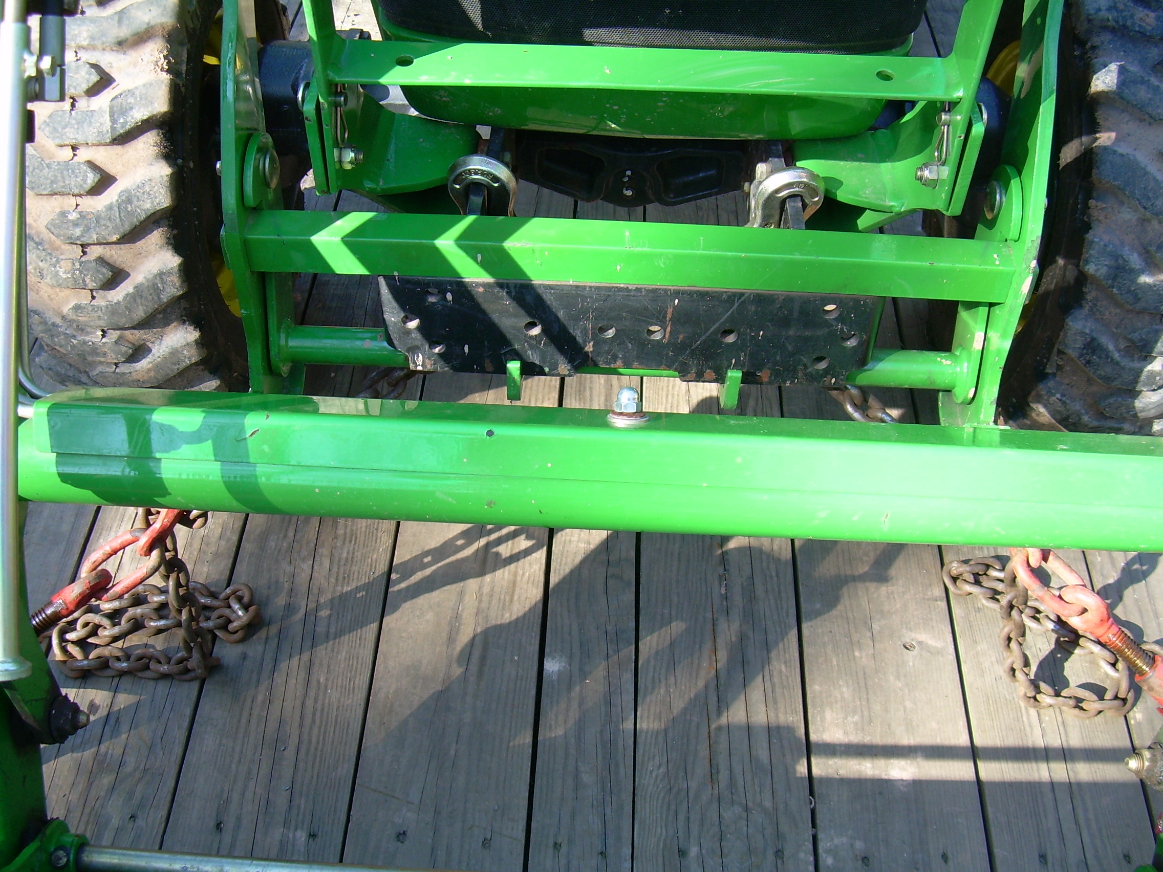

I consider myself lucky having very solid and easily accessible connection points on my tractor, especially being new to trailering myself. Seen some guys where they had to have some kind of D-rings welded on to the frames to facilitate binding them on a trailer, which would be a worthwhile investment if you had to do it.
Here's how I did mine.
JB.

I really like your set up JB4310. The pictures really help. 1000 words X's 3!!
I've bought the Grade 70 chain. It came in 20 foot lengths. From what I see you are using about 10 feet per corner, maybe less. Did you cut yours or did you just buy the length you need. I already have two 20 foot lengths so I'm thinking of cutting the middle link and get more Grade 70 hooks.

bduke- you should study jb4310 pictures closely. If you can take a moment and look at the chains going through the stake pocket and then back up and the hooks is simply resting there going down. This is the federal DOT preferred way of chain attachment on the trailer. The reason behind it as i understand it is that if the chain ever gets loose, the chain won't be flapping all over the place and its still secured on the trailer. I just wanted to point this out since this is how the pros do it too.;)

I'm brand new to equipment trailering so I was reluctant at first to use the stake pockets to attach chain to, thought they were for wood stakes, but everyone assured me that's the way to do it.
JB.
