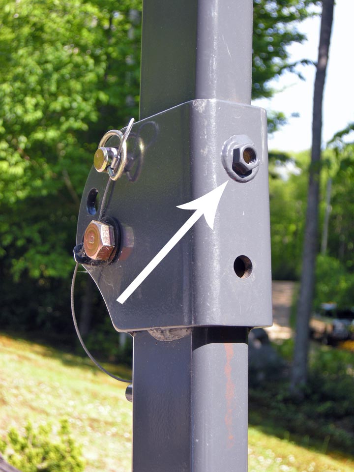

On the ROPS hinge on my B2620 there is a nut welded on.
What's it for?

My tractor has a knob there on each side to keep the ROPS tight.
Deano
   / B2620 - What is this? #3
That would make sense. I put a small piece of rubber on each side to stop the ROPS from rattling. Now the better question is why it didn't come with knobs?!
   / B2620 - What is this? #4
Kubota would kind of hate to spend that money if it happened not to rattle, but it is an easy way to please a customer if it does. Mine came without any bolts, or knobs in those holes too.
   / B2620 - What is this? #5
Mine too!!:confused:B2920
   / B2620 - What is this? #6
I'll be looking for the Bolts w/Knobs. thanks to you all.

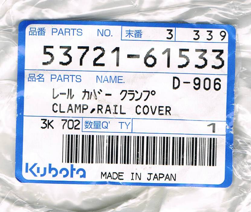

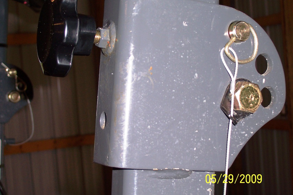

I took a chance and ordered the ROPS knobs from the BX24 to see if they would fit the B2620. They do. They tighten the ROPS up perfectly and should have come with the tractor in the first place.
