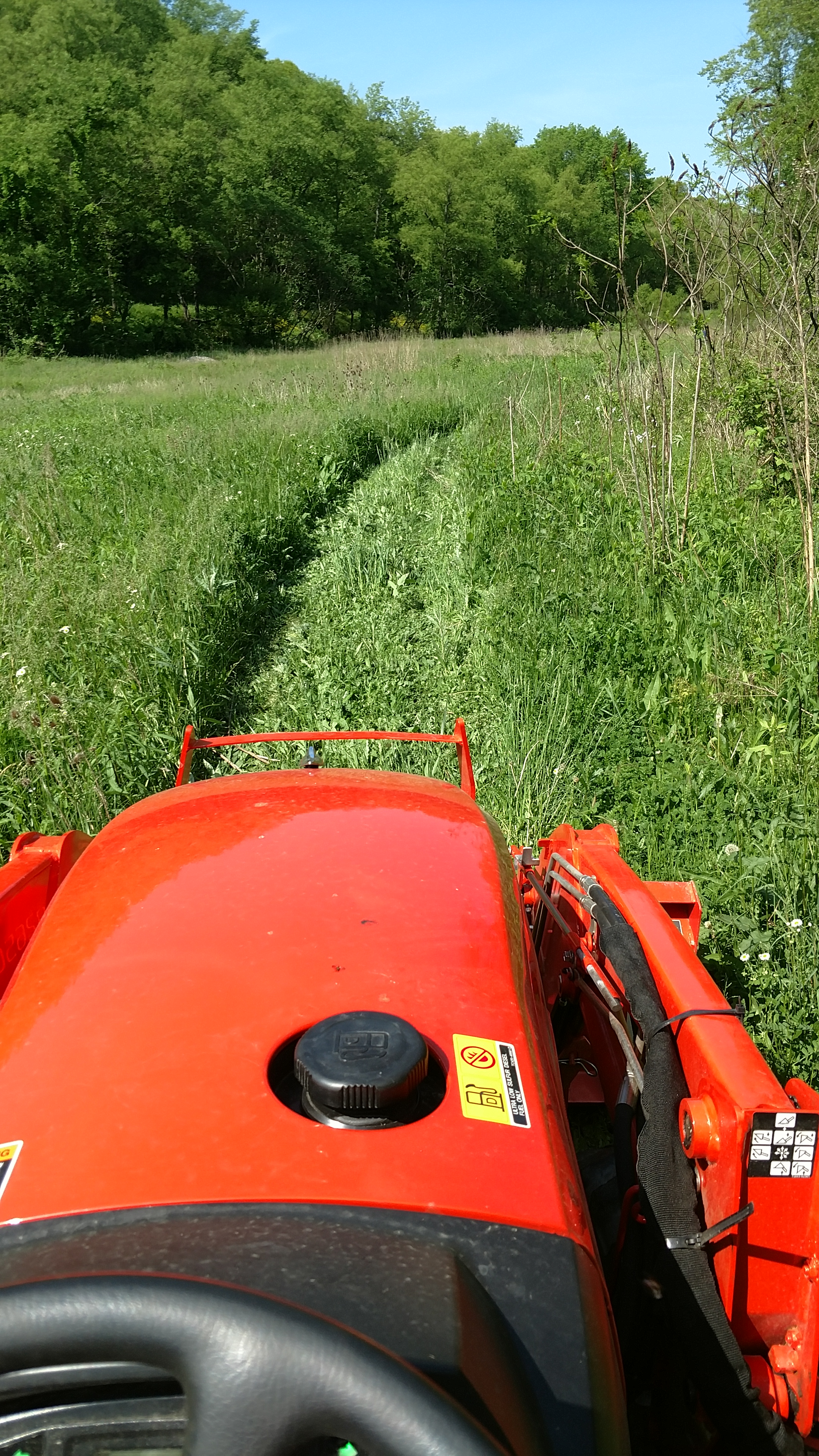

I've noticed this only 2 times in the past, in cooler weather, while working the tractor hard. Normally if I stall it out while consistently keeping the engine under a heavy load and bogging it down it will re-start immediately. 2 times this spring it scared me a little as it would light the dash but no starter... I leave it sit for 10 minutes (trying every few minutes to hit the key) and magically at some point it will fire up and run like normal.
Yesterday I was working the bajeezus out of it in low range, full throttle, pulling a mower in a 4 acre flat field that had growth ranging from 2 feet of grass to 4/5 feet jaggers (not sure what you non western PA folks call jaggers, it is like the stalk of a rose bush with the jaggers all over that make you bleed). I would modulate the HST pedal to keep rear PTO speeds at 450-520 as I worked through the overgrowth. 2 times I let it bog to hard and stall out, both times it refused to do anything but light the dash for about 15 minutes. During this I was seeing 4 to 5 bars on the digital temp gage. Normal light operation shows 3 bars.
Is there an over-temp safety built into this thing that prevents the starter from responding until it sets and cools down? It has never shut itself off, it is always following a heavy lug and stall out. And always when the engine is under nearly constant heavy load with full throttle and some amount of pulling it down in RPMs.
I'm trying to understand if there is a problem, or if this is a built in safety and I should not pay it mind.
