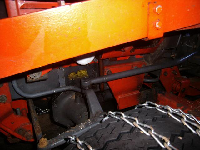

On a serious note:
Can you bolt several pieces of angle iron to the tractor frame and have them extend a little out front. If so then it should be possible to make a box to fit the angle iron and use sand bags as weight. :D
Seems my midmount mower and loader are bolted to the main frame of the tractor. The tractors parked in the trailer but I may be able to get a picture.
   / B7100 Front End Weights #10
Three pictures:
