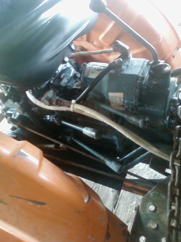

Ok so this is my first tractor. Not wanting to bother anyone, I bought a user manual. But it is of no help because I have a manual transmission and it is for a HST.
On the right hand side there are 3 levers.
What in the world are they for?
I can guess that one is HI-LO, one is 4WD, and one is who knows.
And there is the most confusing sticker that tries to describe "creeping speed,low / high in a table format.
Im really not all that stupid, but I am tired of guessing.
Please tell me what you think these levers do.
p.s. how are there 6 forward gears with only 3 forward stick positions? I think I know but I'll ask anyway.
thanks in advance
   / B7100 help - What are all of these levers for? #2
Welcome to TBN, I put numbers on your photo but I don't really know the correct answer as to which one does what but thought adding numbers might help someone else... help you.
I can answer: Three low gears + three high gears = 6 forward gears. The unknow handle, is most likely the PTO on/off.

Thanks TEG, the numbers help.
I have posted a new thread asking someone to identify the mystery box mounted on my tranny.
That is where the 3rd lever is coming from and why I am having trouble understanding the relationships of the 3 levers.

#3 is your mfwd lever... up is two wheel, down is four, "down for dirt" is how I remember it.
#2 is your hi/lo range... start driving and its pretty obvious which range you are in.. up is lo range.
#1 looks like you have an add-on pto pump on top of the transmission. I have only seen pictures of this. I would imagine one position is ON and one is OFF.
