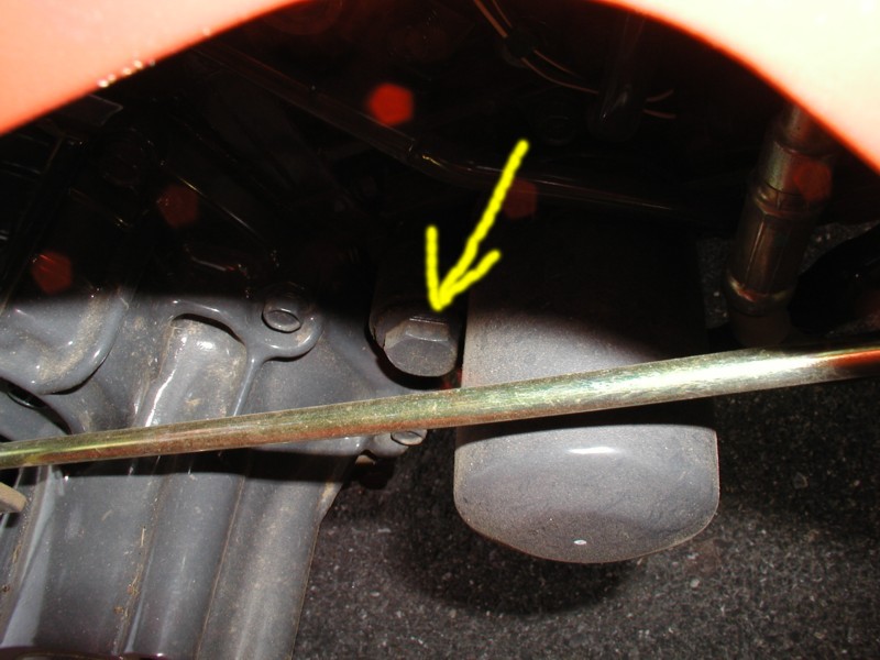

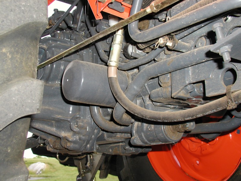

Snowman, Here is a pic of the left filter. I don't know the date of manufacture of mine, but assume it was recent. It was in a crate till about two months ago. Behind the filter is the screen. It looks like a hex nut holding a banjo fitting. I'll post a top view in the next post.
   / B7500HST 50 Hour Maintenance - Filter ID
Here

Here's the strainer

Thanks for the pictures. I'll have to take a look when I get home tonight. Since I never saw the black left hand filter, that would explain why I could not find the strainer either.
I'm an extremely novice do-it-yerselfer when it comes to this, and I thought I had looked over everything really closely when I changed the hydro oil, including going through the so called manual a number of times and I do not recall seeing any mention of two filters.
Were both hydro filters the same part #?

You're welcome. From comments made by the other poster, maybe all B7500HST's aren't alike with respect to filters. Mine was new a couple months ago, and it is pretty flat where your feet rest - no hump. Filters had different numbers, 66021-36060 (left) and 67955-37710 (right).
I'd be sure to have a look at the strainer the next time you have it drained down. Like I said, mine had caught some filings. My strainer is like a hollow bolt with a long sieve attached to the end. I'll try to attach a sketch...........chim
