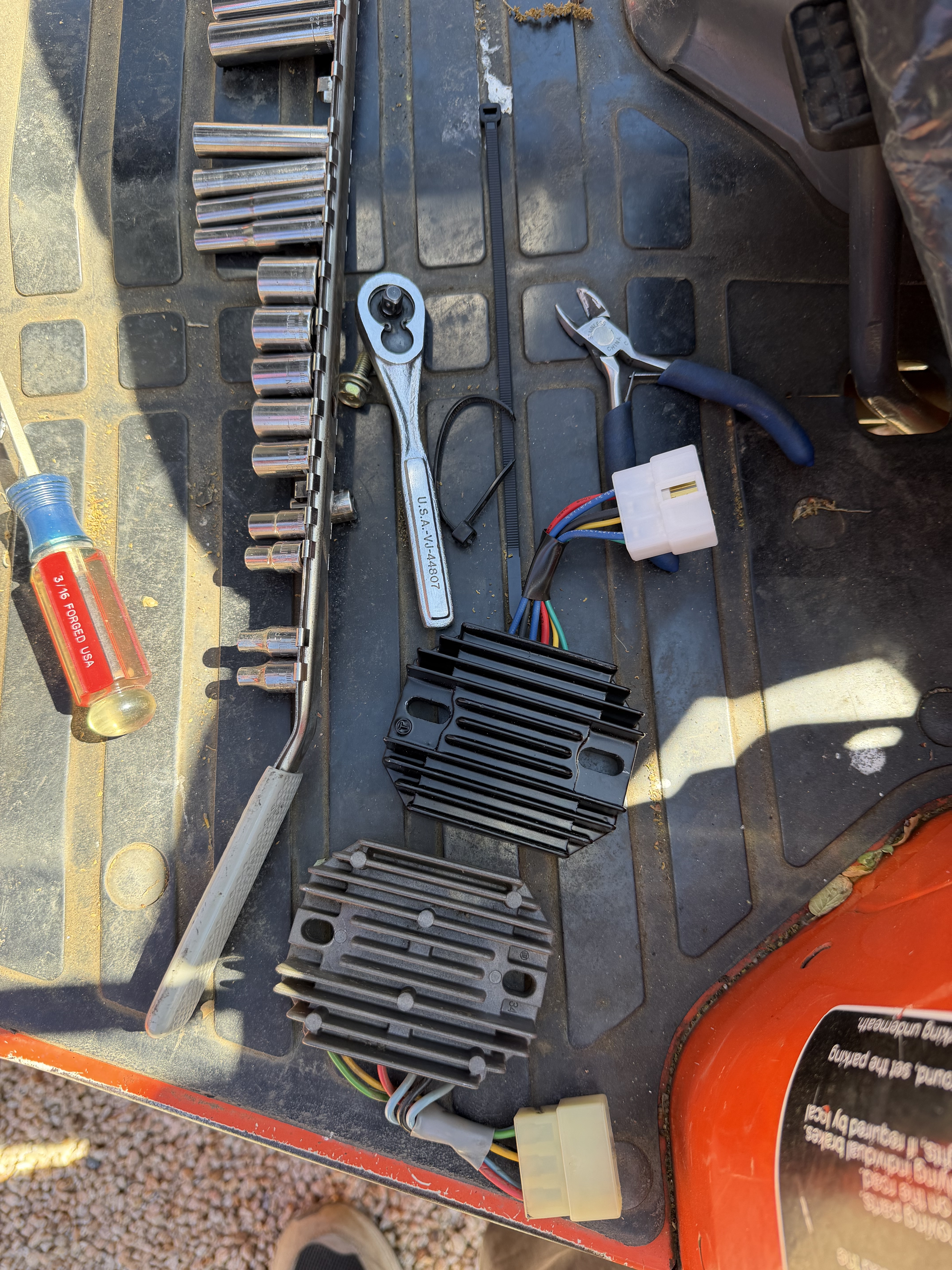

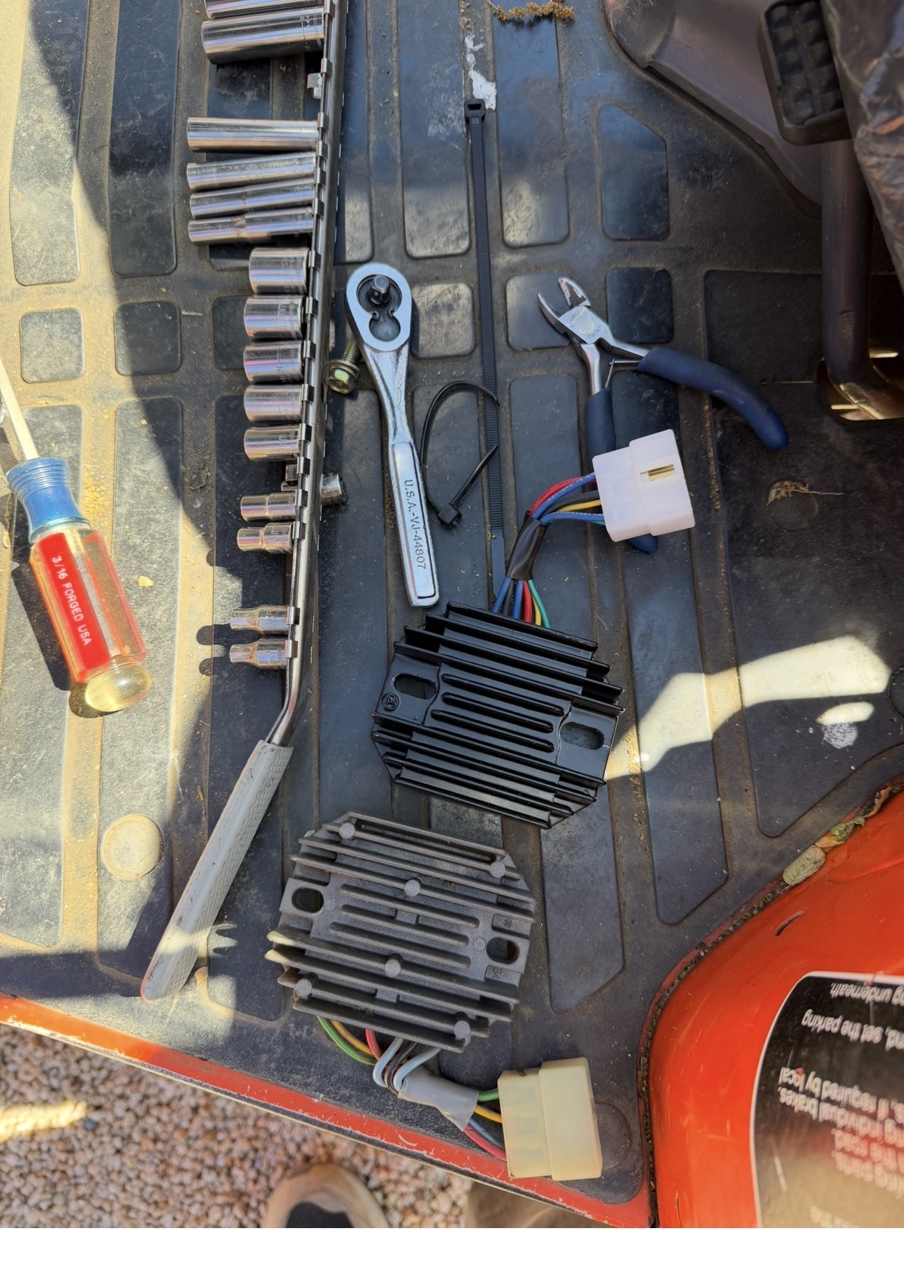

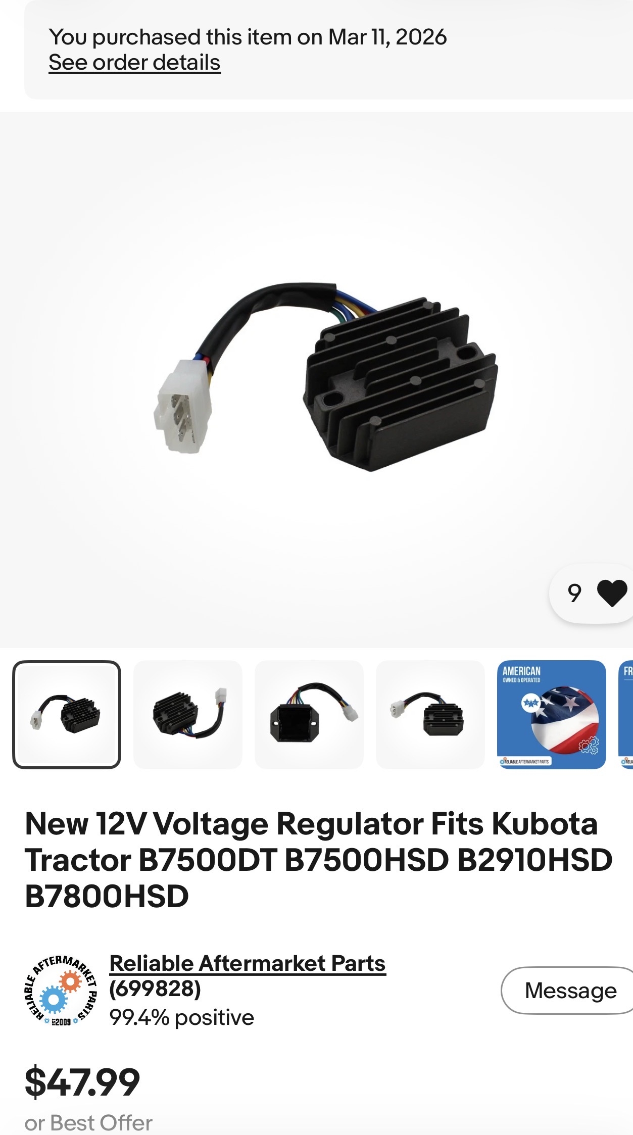

Fixed guys !
Bad voltage regulator underneath the dash . 50 dollar part on eBay. 10 minuteto fix , but took me two weeks to figure out ..at least I didn’t pay someone to fix it !

Hey guys
I have a 150 hour b7800 tractor that is a garage queen . I mainly use it to mow my field. I turned it off and now it won’t crank . Lights all come on though . I checked all the safety switches except the clutch safety switch because I don’t know how to get to it . I see the white connector though . I can easily start the tractor with a long jumper wire I made to go to the positive side of the battery to the starter .It will turn off with the key . Any help before I call a mechanic?
I’ve also tried rocking the forward reverse pedal to its sweet spot with no luck
Fixed guys !
So the battery was dead??!
Nope ! Battery was fine . I did notice the battery indicator light on the dash was not coming on like it used to when I turned the key to the on position.
/ B7800 won’t start #28
Normally a voltage regulator governs battery charging. I wonder what the component you replaced actually does.

Voltage regulator

Voltage regulator
Yeah, that governs charging ... and must interface some other way that that affects the "start" circuitry.
Maybe it has some safety deal built into it
yes your exactly right . Someone on the Kubota face book page had the exact problem I did so I gave it a shot and bought the part . And if that didn’t fix it I was going to buy a new ignition switch .
Six leads! At least 2 more than necessary for a simple regulation function. ... Interesting sleeper problem!

Glad you figured it out.
Keep an eye on that new part. Mine wasn't charging so I ordered a voltage regulator off Amazon. Looked perfect. Identical. Modular plug and wires were identical. Mine got hot and went up in smoke while I was pulling a disc about a month later. Good thing it put out enough smoke and smell that I noticed it -- and good thing I was close enough to the garage to grab a screwdriver and pop the dash off enough to splash some water in there. It was just starting to melt down when I got to it and unplugged it and doused it.
Ended up buying an OEM Kubota part and it's still working fine after about 6 years. Maybe I just got a bad one, but if you notice a funny smell . . . don't ignore it.
By the way, my battery light stayed on all the time and the battery wouldn't charge using the on-board dynamo. Seems my symptoms were different than what you experienced.
