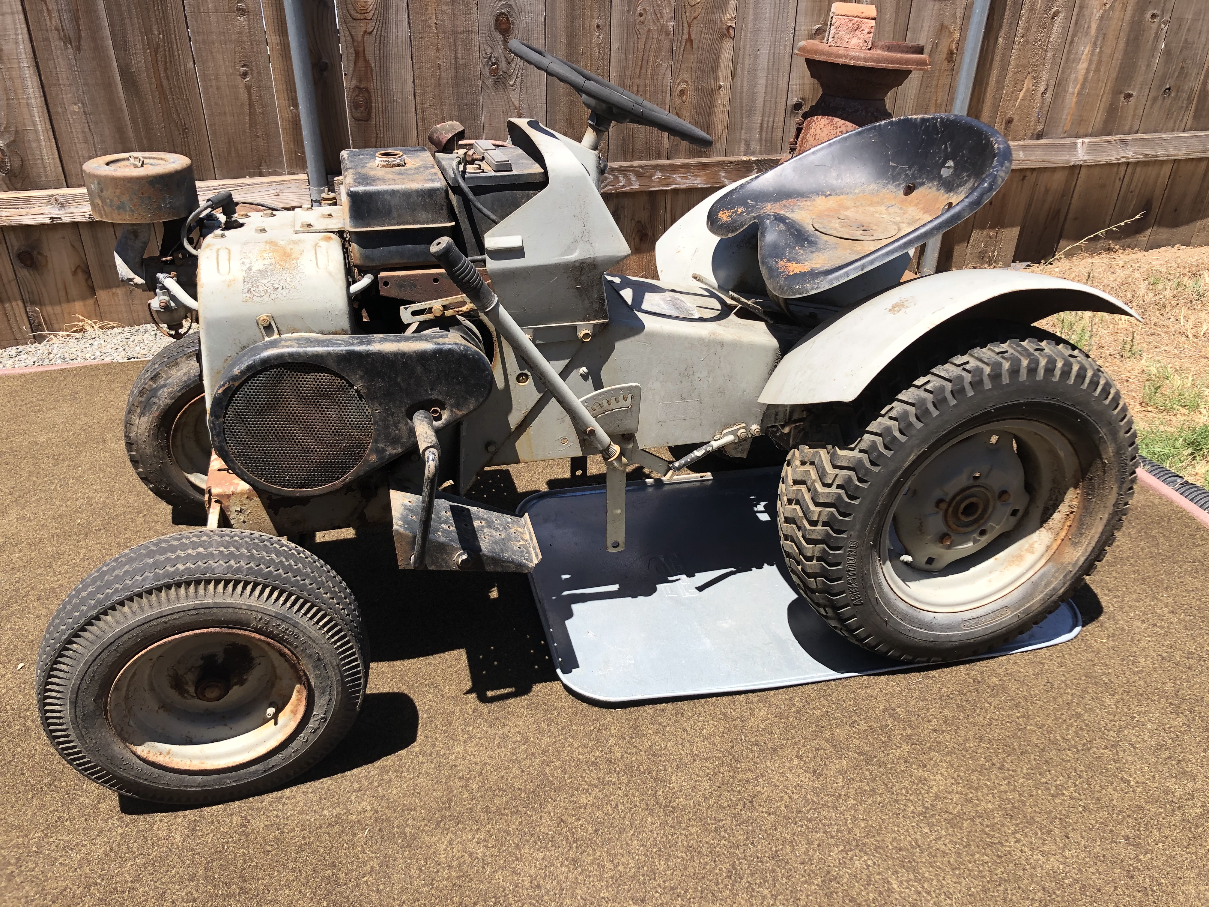

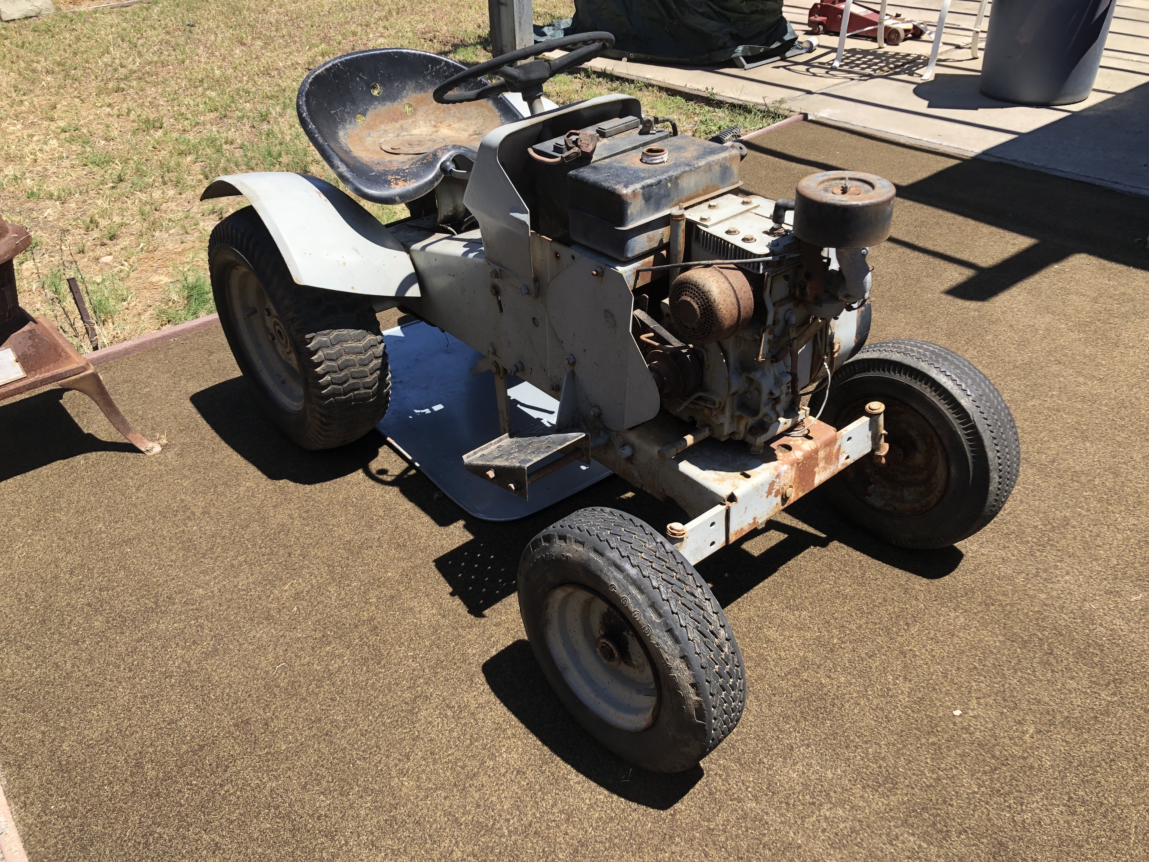

I was gifted a 60s era Sears garden tractor with a totally seized engine. It has a belt-driven 4 speed trans-axle.
I'd love to get it going from the grand kids to putt around with.. might even be able to pull the shaker-screen sand sifter I'm designing.
I'm not an originality nut so I'm not married to getting the old engine running, would be good with replacing it entirely BUT
the motor shaft is on the right... all the motors I've seen for sale in the 9hp +/- range have the shaft on the left.
Anyone know of an engine in the 9hp range with the shaft on the right?
(I did find an air-cooled single-cylinder Diesel engine with the shaft on the right but it was pricey - way cool though.)

Not sure about you shaft on the right statement, it appeared the actual out put shaft is same as all small motors, the shaft on the right or in front of cooling shroud is probably for belt drive for electric starter....Personally I would forget electric start and just go with recoil starter for grandkids and your putt around "thing"... If really married to electric concept you can probably have adapter made to put a pulley on flywheel side. Have you pulled side cover off and looked at shaft arrangement ?
Cheapest new motor is going to be at harbor freight.....
8 HP (3?1cc) OHV Horizontal Shaft Gas Engine EPA/CARB
6.5 HP (212cc) OHV Horizontal Shaft Gas Engine EPA
For kids toy I think the 6.5 HP would be more than adequate.

That shroud is covering a belt drive the starter would most probably be a starter generator combo. A new electric start engine will have a built in dynamo generator and a Bendix to flywheel driven starter mounted on the side of the engine. it may or may not require a separate solid state voltage regulator some engines come with one mounted on the engine.
If it were me I would go with something in the 10 to 14 hp range gasoline or 8 to 11 hp diesel
