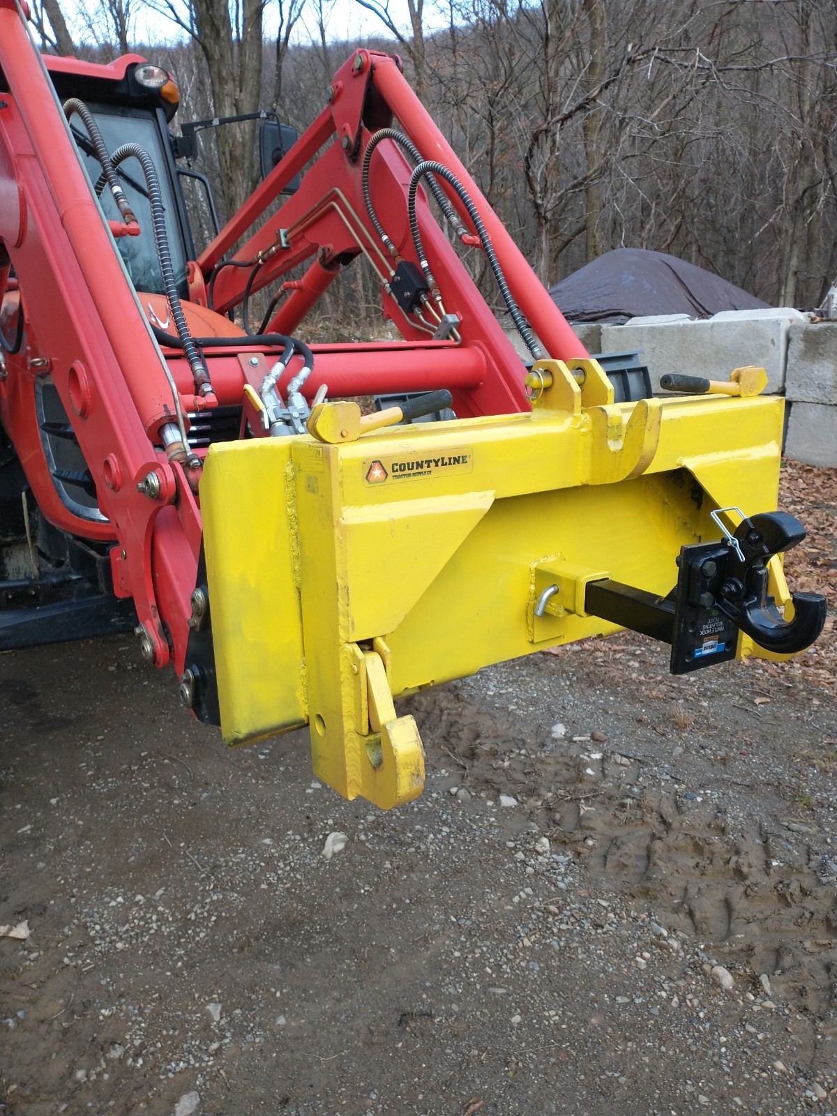

I have a quick hitch mounted to an SSQH plate. I use it for moving and setting things in place it also has a trailer hitch receiver in it.
That said I seldom use it, the most often use is to put 3 pt implements into my little shop that only has a 7 ft high door, when I'm going to work on them.
I was going to use it with my york rake for cleaning debri off my yard, didn't work worth a damn.
It would put your back blade way out in front of your tractor and make it difficult to control.

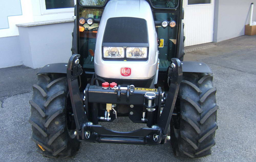

A VERY COMMON set up in Europe. They don't really go for FEL. Practical people! ;-)
Type "Hurlimann Prince" into google foo.
Select images from the menu bar.
Enjoy many images of front mount 3pt.

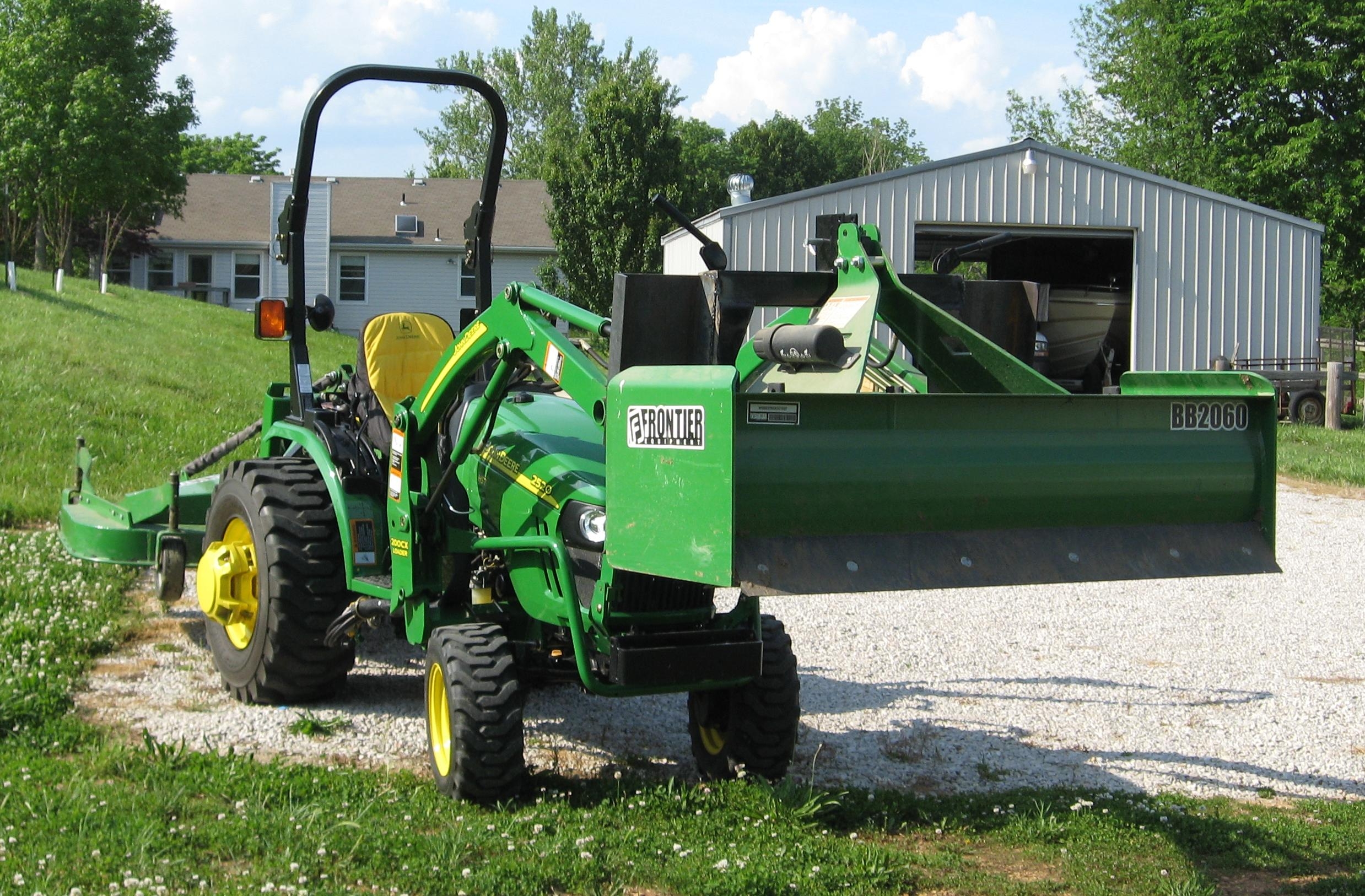

I made a front quick hitch for my JD 2520 and have used it for a rear blade, but not for plowing snow. My situation is that I have a poorly designed compost pile that is surrounded by railroad tie walls on three sides. I use my setup to reach over the pile and pull compost from the rear to the front when turning the pile.
That being said, I am aware that the loader is not really designed to be used in this manner and I am, therefore, extremely careful when doing it. I don't think it's going to hurt using it like this for moving loose material. I would be uncomfortable using it to do very much snow moving, maybe just for pulling it away from buildings/garage doors.
Attached pic is using the QH to move my box blade, but you get the idea.

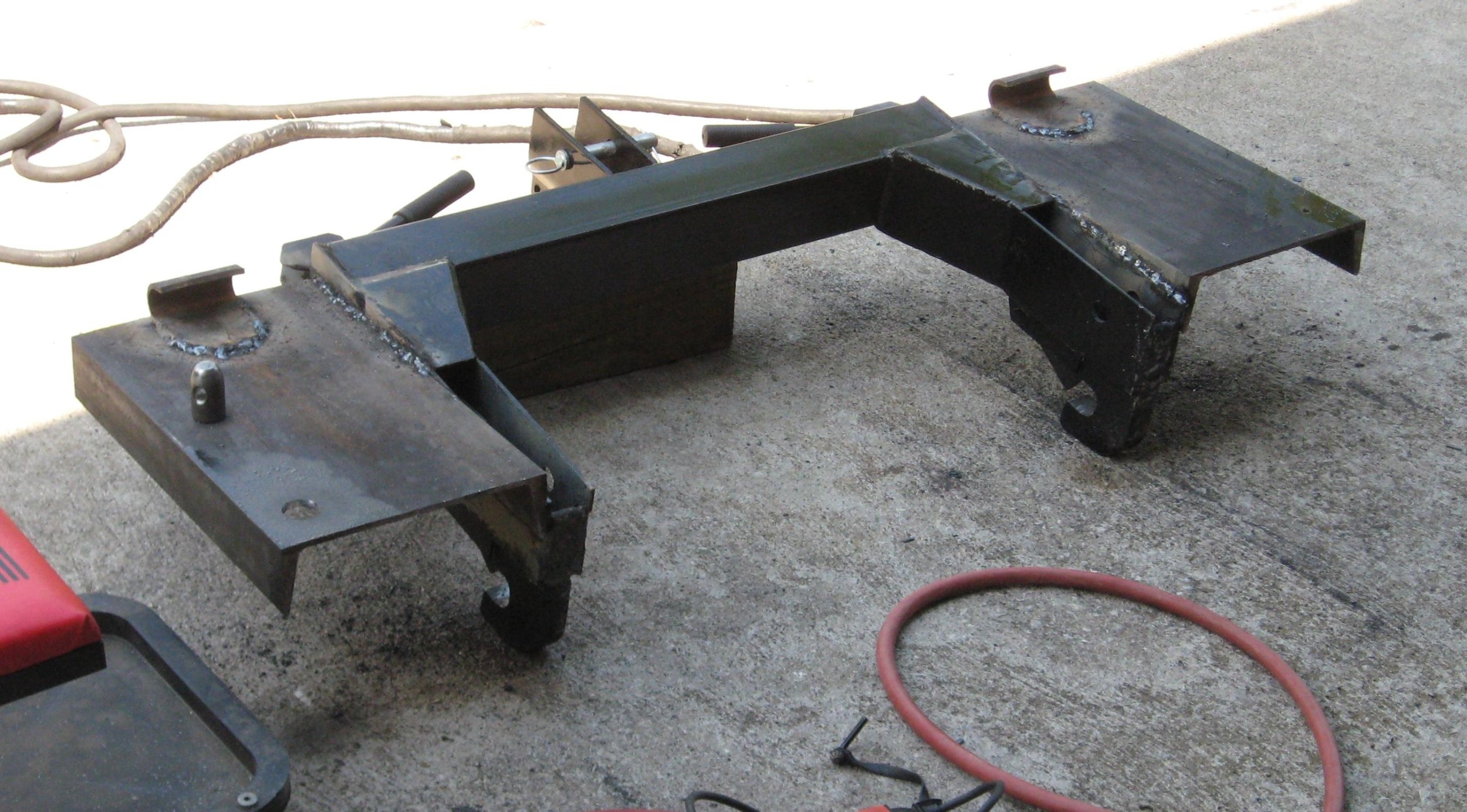

For mine, I just welded a couple of pieces of 11" channel to the sides of a cheap HF quick hitch, then welded the JD hooks and pins to the channel.
