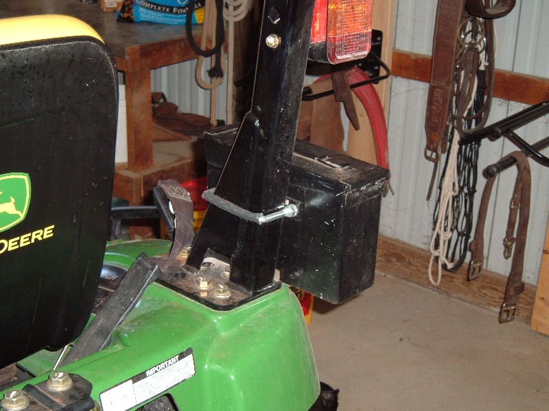

Good job.....where did you get the shackel bolt? or did you heat and bend a threaded rod?:thumbsup:

QUOTE: Good job.....where did you get the shackel bolt? or did you heat and bend a threaded rod?
It is an off the shelf u-bolt from the hardware store with a piece of heat shrink tubing to protect the paint and a spacer to allow the lid to open and close.
(Ammo boxes are bug proof and water tight.)
