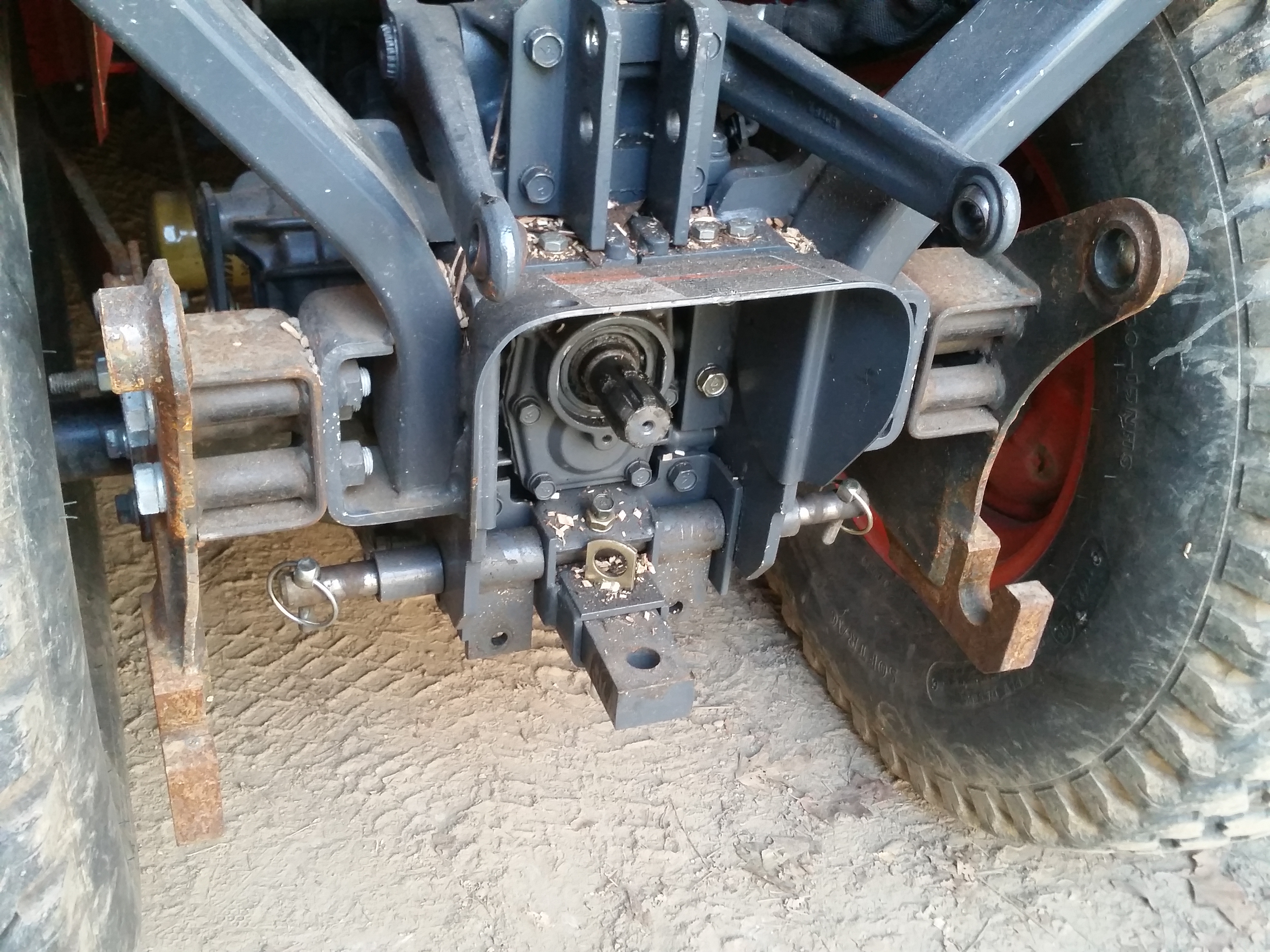

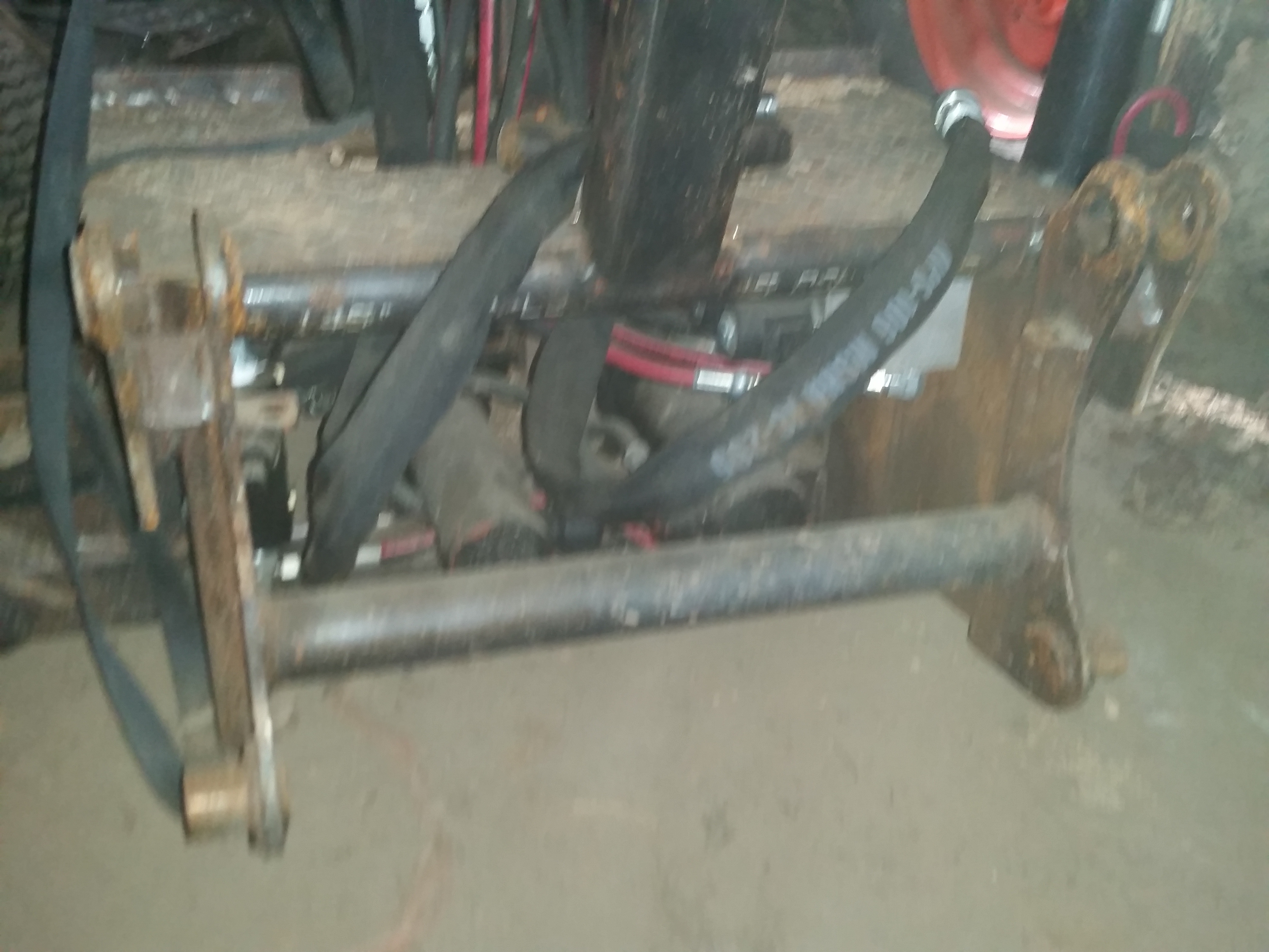

I just won at auction a John deere 8 B Backhoe , with a sub frame . But I have a new holland 1925 tractor . I have a winter project ahead . Anybody done something similar? I havent picked it up yet so I havent seen it in person . Same auction I got a vibratory single drum roller , a grade blade , a 3 pt post hole with a couple bits , a 3 pt tiller , a billy goat leaf sucker and a pull behind spreader . All for 2 thousand

Sounds like you got a good deal for all those attachments.
Making a subframe for the BH isn't hard, if you search this site it's been discussed in length so there should be plenty of info and pictures to look through.
When I built my BH I copied Kubota's mounting for the factory hoe, my subframe stays on the tractor all the time. Tractor side 1465379286099.jpg hoe side 1465379315048.jpg
