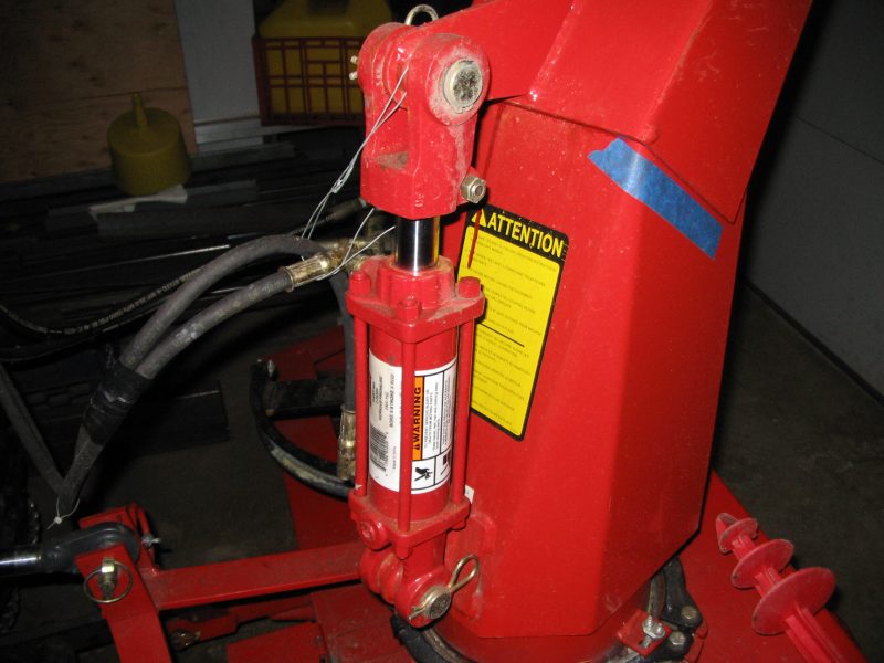

What size cylinder do you have on you deflector? Looks like it should be about a 1 1/2" or 2" with about a 4" stroke.

A 2" x 4" x 1.125" tie rod cylinder with a 14.25" retracted length is a perfect fit. Just remove the existing bar and connect the cylinder. I used a Chief cylinder I bought from Surplus Center (part # 9-4300-04). Use 1/4" hoses with 3/8" to 1/4" adapters to get a nice smooth operation.
