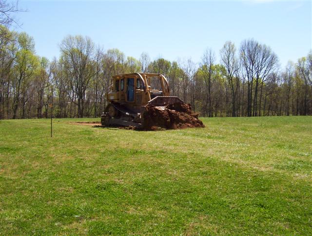

Thought I would share with those interested my barn building project. Be patient on answers to any questions as I am very busy these days, but will get around to answering.
Barn is 56’ x 56’, actual barn under roof is 32’ wide x 56’ long, with a 12’ wide drive thru shed roof storage area on each side, for storing trailer, implements, wagons, junk. Barn will have a Gambrel roof w/ loft for more storage. Walls will be 14’ tall , 2 each 12’ x12’ rollup doors centered in each end wall, some windows, and a 3’service door. Will have metal siding & roof. Will post pics as I progress. Attached pic is start of building pad.

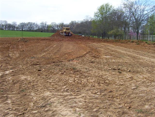

Pad finished

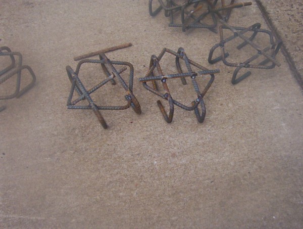

Attached pic is of rebar to go in bottom of holes, concrete cookies then poured in place, after cure , set poles.
More to come.
