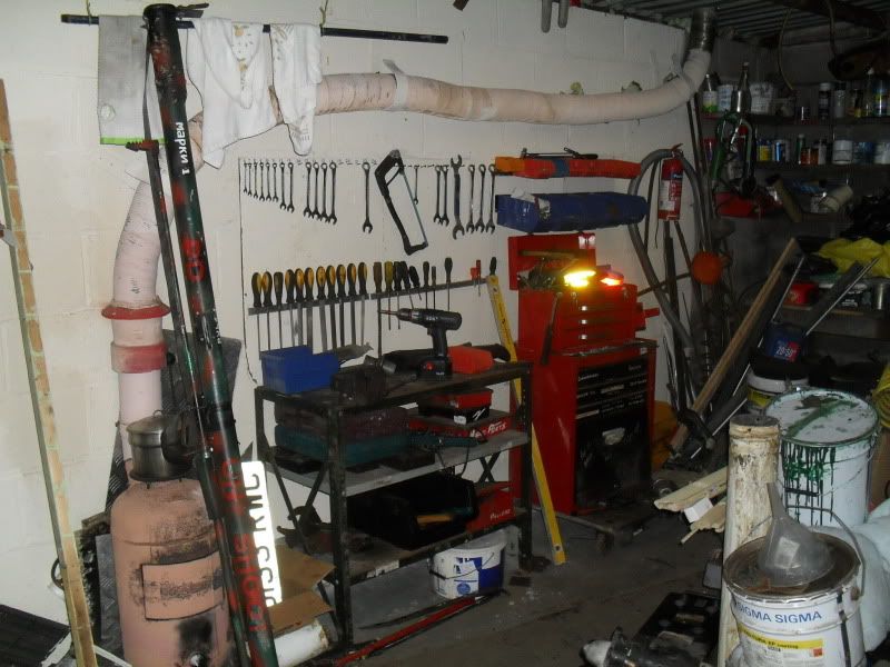

I want to put wood burning heat source in my 30'x50' shop. I also want to do it as cheaply as possible. After talking with some friends who have them I've pretty much settled on a barrel stove. I've seen the kits in Northern Tool and elsewhere. Anyone had any experience with the kits and/or the stoves? Heat output, burn time, actaully making the stove using the kit? Thanks!

Depends on how warm you need the shop to be,
Mine is the size below and our shop is 20 x 30 and it keeps the temp at 50 degrees when it is well below freezing outside
