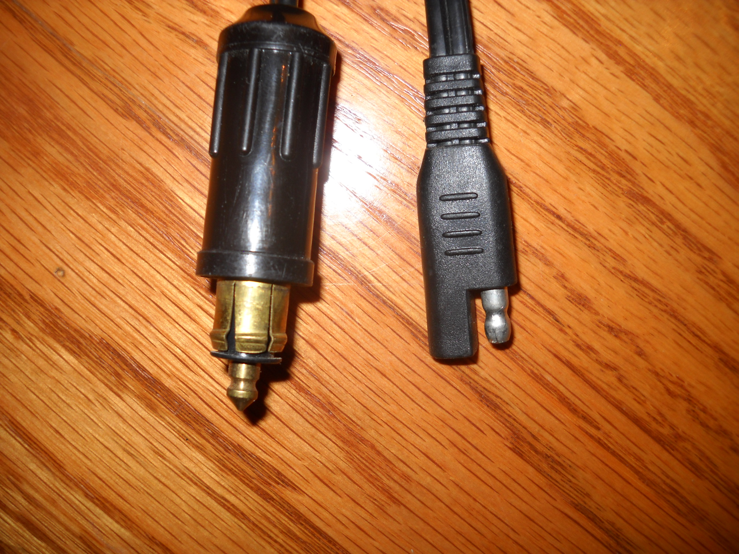

I'll likely install a fused pigtail with covered plug located outside the grill so I will not have to open the hood every time I want to attach/detach the charger.

I have a Battery Tender on my Kubota. The "capped pigtail" sticks out of the front corner by the grill. Easy to plug and unplug. I also use one on a built-up Jeep that only see 5-6K per year. I've also used them on other vehicles in the past...I swear by them!

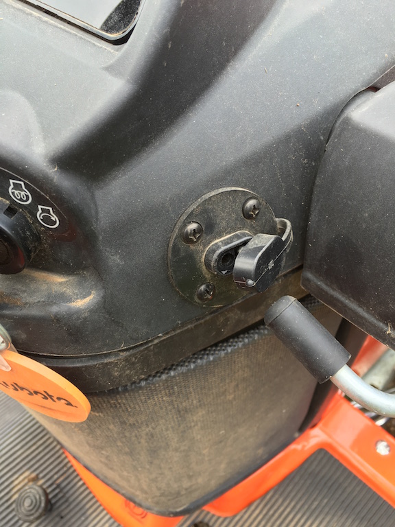

Here is what I did. Wired direct to battery terminals. Connector on dash right side. Use the Deltran Battery Tender on my BX tractor, Z-turn, and generator. Expensive ($50) but worth it IMO.
