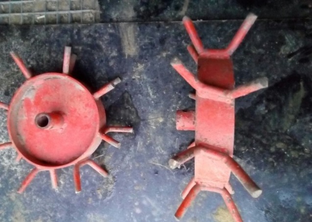

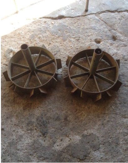

Hi and thanks for your reply and the welcome. Attached are pictures of a couple of wheels I found for sale in my neck of the woods (Belgium - though I'm Canadian). They seem to be a different system to what Earthtools offer and when I spoke to one seller he said to measure the axle. Your suggestion of drilling holes to match the hubs got me thinking maybe I could I cut off the 'axle attachment' in the picture and drill to match the hub, but I don't think that would give enough clearance for the engine. Forgive me if this is stupid newby question, but do the wheels need to be the exact same size as what I have or is there some tolerance with that?

Those do look a little small in diameter, there is some tolerance, but as you change the outside tire diameter, you change the tractor ground speed, larger=faster. I can see where engine clearance could be an issue with those. Another option to improve traction is to add weight. I can add about 80 lbs of barbell weights to the wheels, and can add more to the engine if needed. I also have foam filled tires that add another 40 lbs/set, and if I get really wild, I have another set to make duals, plus I filled the 6" wheel extenders with lead for another 16 lbs. Don't need it often, but the wide duals help when mowing steep areas. I have pulled the hubs to work on the brakes, but I don't remember the axle being something you could slide that type of wheel over. May be possible to make a barbell type adapter to bolt on the existing hub, but not sure if you could get it strong enough. I would try weights and regular tires first, cheaper and easy to change. I use my 850 with a potato plow with weights, no problem, but I have never tried a turning plow. Another thought is to add a set of tire chains, they do help traction. Mine are cut down car tire chains, usually of snow, but sometimes mud.

All good tips - thanks for your help and time
