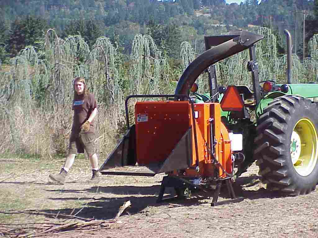

I have had my BearCat 72854 for 3 years or so.
It is a PTO driven 8" chipper with hydraulic horizontal feed and electronic feed rate control.
I like dedicated chippers as opposed to chipper/shredders. The shredder function causes compromises in the design.
The only problem I ever had was with the feed rate controller not working. Turned out to be a dealer installation issue.
I absolutely love the chipper. I can feed it a 30+ foot tree and walk away to get the next one. It just chomps away, moving the tree in and out as necessary and crushing the branches as it goes. Everyone likes to feed it, even my son's will leave their computer games to come feed the chipper!
Here is a shot of my son and the beast.
