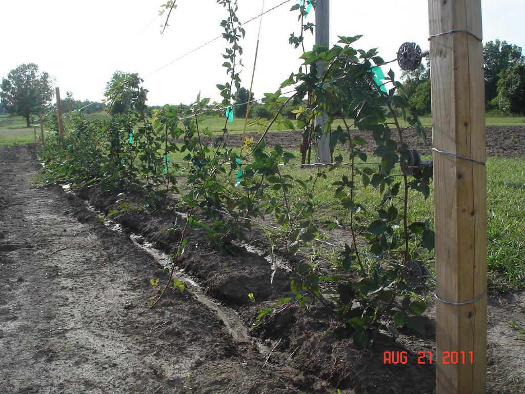

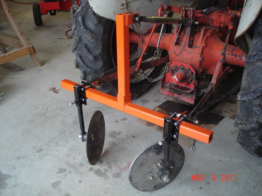

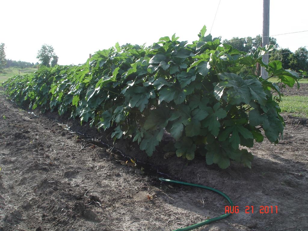

   / Bedder/hiller fabrication #7
Agri-Supply is where I got the discs. Made this simple hiller. Works pretty good, as long as the ground is worked. Will hill up about a foot, and leaves 2 furrows on either side of the hill. In the dry summer, I flood the furrows to irrigate the rows. Mark
