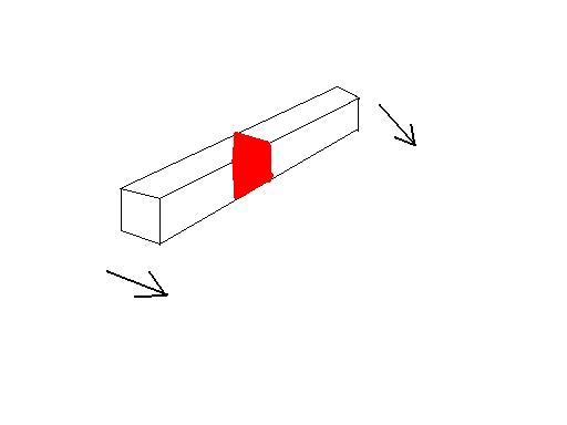

Heat shrinking is very easy to learn once you get around someone who knows how to do it. I learned from a guy who learned from the guy who did the beams on the Seattle Space Needle. I'm really good with shapes, little weak with plate.
Here is an example of the wedge technique.

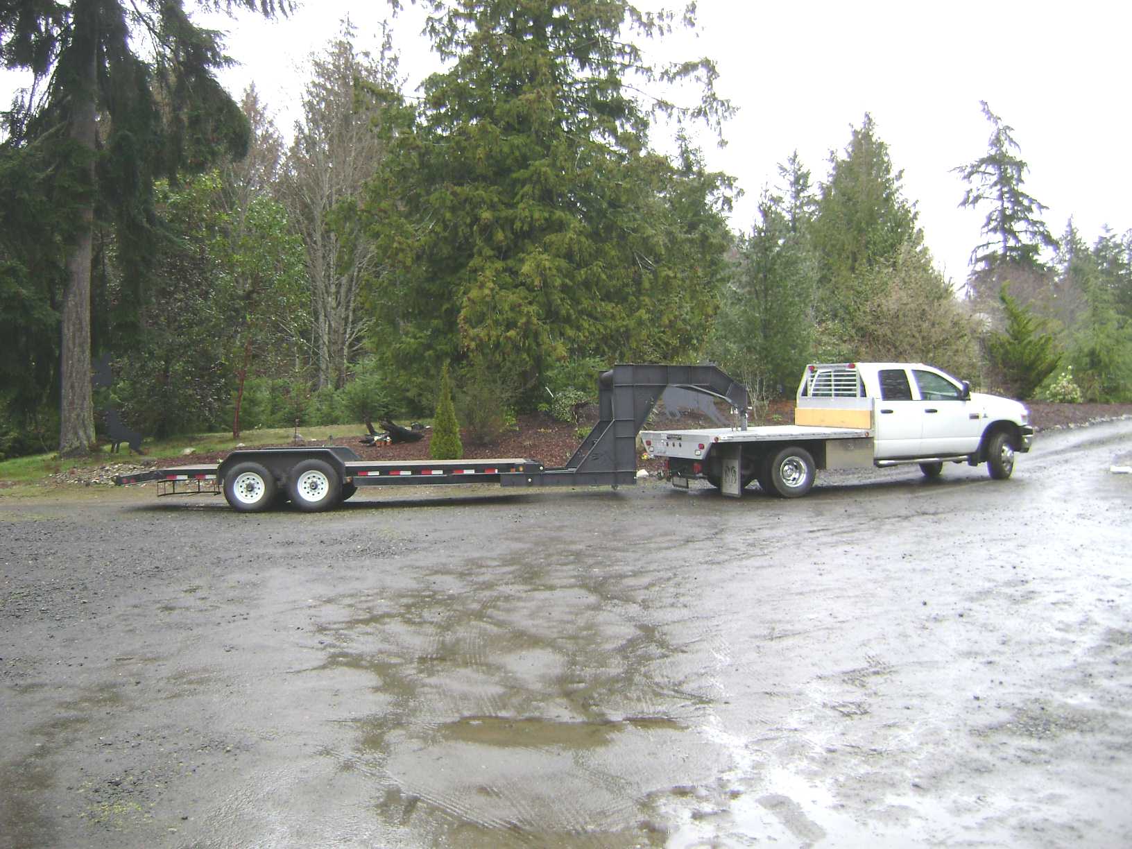

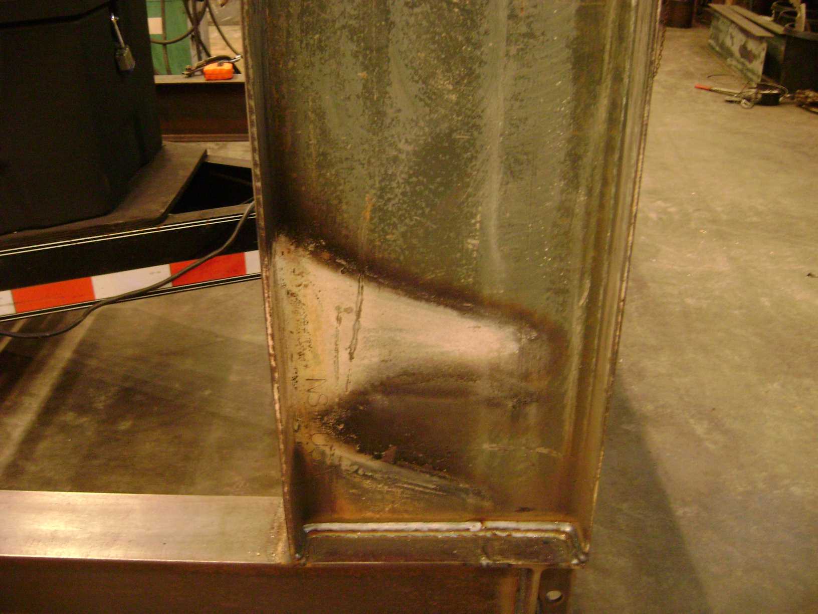

I think you really need an O&A torch! I just can't imagine doing this with a Tig torch. When I built this gooseneck adapter for my trailer, one of the uprights, (12" x 19-pound S-shape) pulled out of plumb, little heat in the correct spot, bingo perfect.;)
