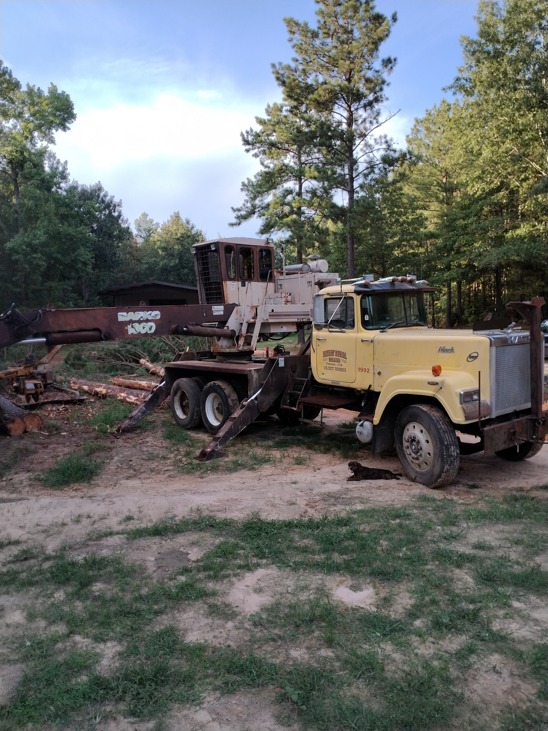

I go to the car wash. But mostly I just slosh a little gas around in it and keep living life. I'm using 15 year old diesel now. We bought an 85 Mack superliner that's been sitting that long. But, it had two long full tanks. 300 gallons or so. We took fuel tanks off. Got a hydraulic wet kit for a dump truck trailer and used that tank for fuel, behind the cab, on frame, and put a log loader on rear of truck. Lot more clearance without them high way fuel tanks hanging down there.
