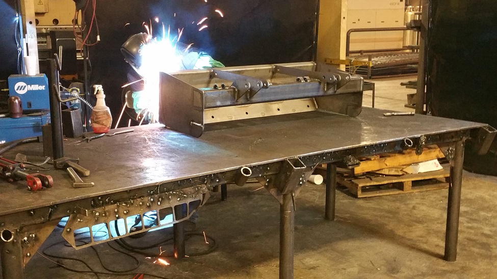

Anything on our website will ship free to YRC Freight in Elmira.
This is an awesome box blade for your tractor and for the dollar: Land Shark 2.1 Compact Box Blade
We'll even paint it EA Yellow to clash less with blue!
Box Blades by EA feature:
US Made cutting edges.
Horseshoe plates of steel on the bottom of the tube behind ripper shanks for durability.
Extra plate of steel on the front leading edge for wear resistance.
Laser cut, A572 steel construction; tabbed and solid welded.
