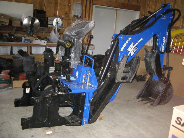

Here's how I store my BH.
Really need to build a dolly for though. Makes remounting so much easier and faster.
