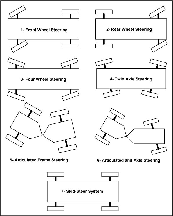

Any bright thought about the best Steering / Tractor combo . . . or maybe even the other direction -- the Do Nots for these . . .
For a sort of Robotic / Autonomous / Semi-Autonomous field tractor rig?
Figure this will be Electric, All-Wheel Drive. Small battery for general mobility, and then Cord-Connected when it is time to get-to-work.
The sketch below covers the general options. The skid steer could also be a "track." (Skid Steer works with just rights or just left wheels turning. Sometimes one side forward and one backward for zero radius turn).
I guess they missed the Zero Turn mower style. Suppose I should include that. Well, cannot find a decent sketch. I guess you know how those work? Two forward-reverse drive wheels, along with "dumb" caster wheels, up front.
So which is better or best and why?
Thanks!

All of them obviously.
   / Best Steering / Frame / Tractor Combo -- for Robotic-Electric. #3

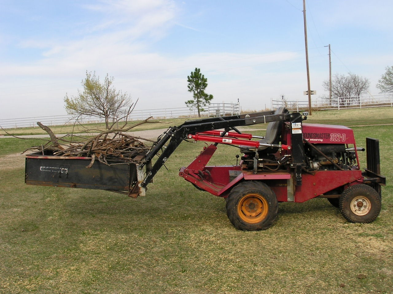

#3 will give the best turning radius without whipping the loader or other fixed attachment the way an articulated design does.
I figured #2 was the weird one, until I considered that is how every (?) Combine works.
